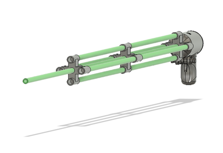

Step 1: CAD

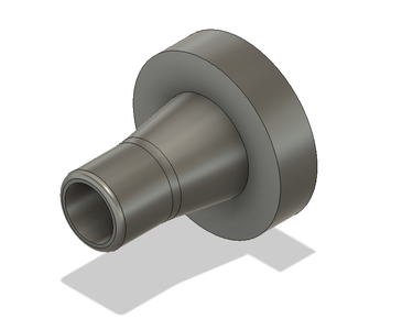

I CADded all the components in Autodesk Fusion. I used the Sketch and Extrude tools as per usual, but I also used the Circular Pattern, Mirror, Loft, Fillet, and Thread tools to round out my design, distributing any stress applied to the model.

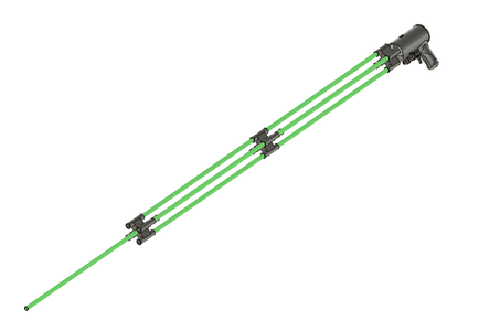

Step 2: Connectors
There are two types of connectors I used:

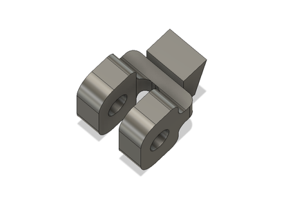

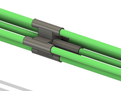

TYPE A CONNECTOR: This connector consists of a short rod with holes on either side. Two poles can be fitted into this part. With two of these connectors, I joined three rods together.

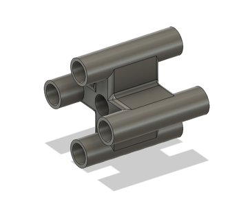

TYPE B CONNECTOR (SLIDER): This part has four tight holes on two sides, and a single loose hole through the entire part for one rod to slide through. I made the four-rod solid shaft of the gun with these connectors, and reconnected the central rod with the type A connectors between the loose holes.
Once I was done, I had a solid shaft with a single sliding rod in between it.

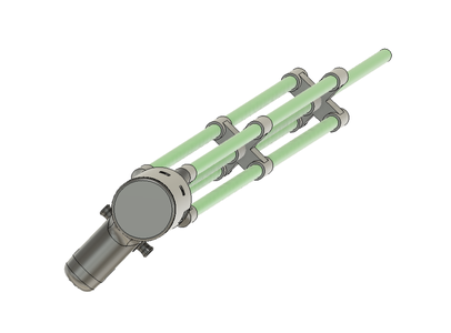

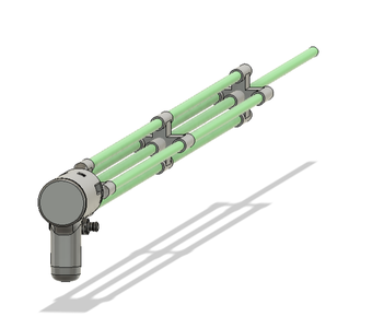

Step 3: Spring Housing
This is the largest component of the rifle and took me the longest to design. It consists of a handle attached to a hollow cylinder housing that is home to the springs of the rifle. To CAD this component, I took the slider connector model and worked with half of it as the part to interface with the rifle's barrel.
I attached four rods from the main shaft to the spring housing like with the slider connectors. I then slid the center rod into the loose hole in the center of the housing.
Step 4: Inserting Springs
Now that the sliding rod had been inserted, it was time to load the springs into the firing mechanism. I took the six springs and three components: the Spring Rod Connector, the Spring Partition, and the Spring Screw. I slid the springs into each of the holes in the Partition, and attached one side to the Spring Rod Connector, which I then inserted into the spring housing. I connected the Spring Rod Connector to the sliding pole inside the spring housing. Finally, I attached the three exposed springs to the Spring Screw and screwed the entire thing into the chamber.
If done correctly, the sliding rod should rotate along with the spring screw. If not, the springs may fall out of position and the tolerances may be too tight.

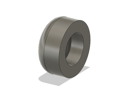

Finally, it was time to bring everything to life. I printed out the final seven components: two pairs of pins and corresponding caps, the trigger, the lock, and the spacer (this was initially intended to be a reload mechanism, but was just changed to simply act as a large washer). The spacer goes into the spring housing. I had to unscrew the spring assembly and slide it in, then screw the springs back in again.
