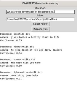

# Graphical user interface code is below
# Using the "filedialog" submodule which will allow user to choose
# folder by running the "askdirectory()" function
# This block only runs if the script is executed directly (not imported)
if __name__ == "__main__":
# Define select_folder function will allow user to select a folder and update the GUI
def select_folder():
# the askdirectory function will allow user to select directory to scan
folder_path = filedialog.askdirectory()
# Clear any existing text in the folder entry field
folder_entry.delete(0, tk.END)
# Insert the selected folder path into the entry field
folder_entry.insert(0, folder_path)
# Define the "run_analysis" function
def run_analysis():
# Use get() function to retrieve data from "question_entry" widget
# Place data into "question" variable
question = question_entry.get()
# Use get() function to retrieve data from "folder_entry" widget
# Place data into variable "folder"
folder = folder_entry.get()
# Run the "extract_breastfeeding_info" function
# Use the folder and question variables in the function
# Place the results of the function into the "results" variable
results = extract_breastfeeding_info(folder, question)
# Remove everything from the "results_text" widget
results_text.delete('1.0', tk.END)
# if there is data in the "results" list
if results:
# use lambda function to sort in reverse order
# based on the 3rd element in each one
results.sort(key=lambda x: x[2], reverse=True)
# Using for loop, iterate through "doc", "answer" and "score" in results list
for doc, answer, score in results:
# insert variables "doc", "answer" and "score" in "results_text" widget
results_text.insert(tk.END, f"Document: {doc}\nAnswer: {answer}\nConfidence: {score:.2f}\n\n")
else:
results_text.insert(tk.END, "No answers found with sufficient confidence.")
# Create the primary window with the "tk" toolkit using the Tk() class
# Assigned to variable "root" and called the root window
root = tk.Tk()
# Sets the title of the "root" window
# This can be changed
root.title("Breastfeeding information using local AI engine DistilBERT")
# Create a label widget in the main window called "Question" using pack() method
tk.Label(root, text="Question:").pack()
# Create text Entry widget in main window, 50 characters wide
# Assign it to variable "question_entry"
question_entry = tk.Entry(root, width=50)
# Use pack() function to place in main window
question_entry.pack()
# Create a Label widget called "Folder"
# use pack() function to place in main window
tk.Label(root, text="Folder:").pack()
# Create text Entry widget with 50 character width
# Assign it to variable "folder_entry"
folder_entry = tk.Entry(root, width=50)
# Use pack() function to add it to the main window
folder_entry.pack()
# Create buttons below
# Create Button widget called "Select Folder"; use pack() function to place in window
# When clicked, run "select_folder" command
tk.Button(root, text="Select Folder", command=select_folder).pack()
# Create Button widget called "Run Analysis"; use pack() function to place in window
# When clicked, run "run_analysis" command
tk.Button(root, text="Run Analysis", command=run_analysis).pack()
# Create Text widget, 20x60 characters
# Associate with variable "results_text"
results_text = tk.Text(root, height=20, width=60)
# Use pack() function to put "results_text" into window
