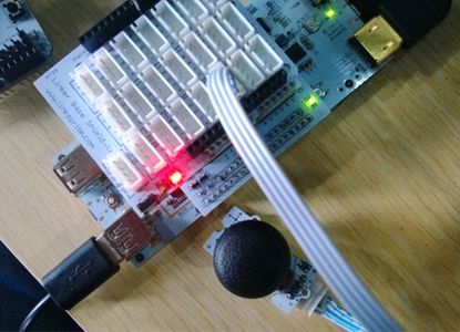

The JoyStick is connected as following:
  1. GND of JoyStick -> GND of pcDuino
  2. VCC of JoyStick -> 3.3V of pcDuino
  3. x of JoyStick -> A2 of pcDuino
  4. y of JoyStick -> A3 of pcDuino
