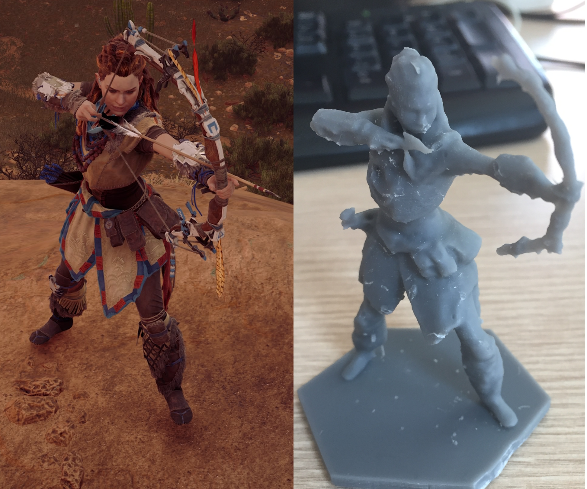

Introduction: Run Photogrammetry in the Cloud
If you don't have a high-end gamer PC with 16 GB of RAM, and your video card is old, then you most probably need a very long time (up to 8 hours or so) to finish the photogrammetry part and need to tweak with the settings to work. Also, if you don't have a CUDA capable NVIDIA video card, then the DepthMap and DepthMapFilter steps couldn't be processed on your PC.
In these cases, you might want to process your screenshots in the cloud. On Amazon Web Services, you can "rent" virtual machines (called cloud computing instances, or instances), which have the necessary power to process your photogrammetry in a relatively short time (eg.: processing 300 UHD pictures into a 3D model took about 2 hours for me, 80 UHD images took about 40 minutes).

Photogrammetry is a procedure to reconstruct a 3D model from 2D pictures of a subject.
In order to do it, you have to take photos from many different angles of a subject standing still, without changing anything in the scene.
If the subject is an item or a sculpture, you can not move it between shots, because its pose and environment play a big part in the reconstruction. If you change the conditions, the photos won't describe the same 3D "snapshot" of the world anymore, and the software couldn't reconstruct it so well.

3 years ago
That turned out great!
Reply 3 years ago
Thank you!
