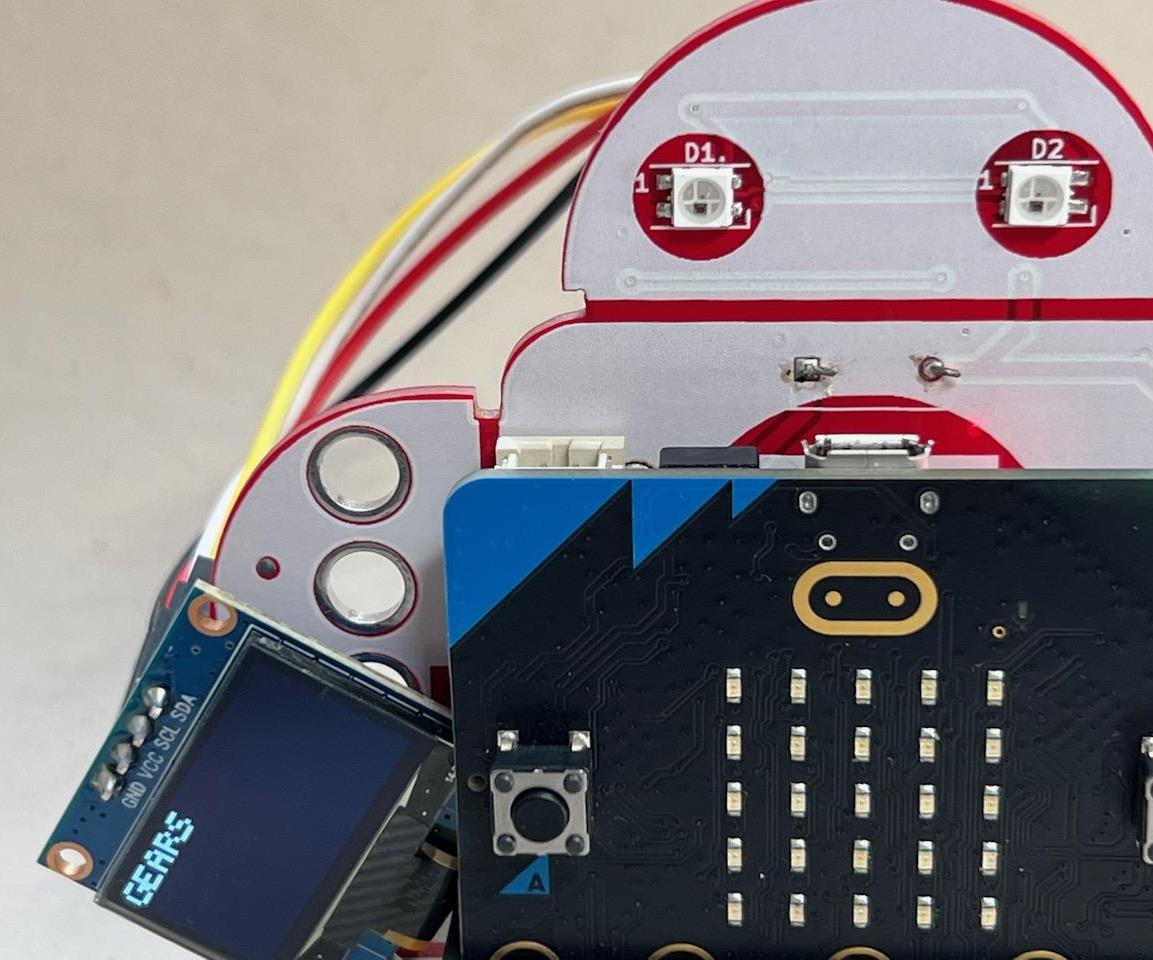

Step 3: Attach the Motor to the Chibi Clip
The motor has three wires: the red is "power", white (some motors use yellow) is "signal", and black is "ground". We are going to attach them to the corresponding parts of the Chibi clip.
There are many different ways to physically attach the wires to the clip. The main thing is to be sure that the wires remain in contact with the connection points on the clip.
Attach the black wire to the GND part of the clip; the white (or yellow) to the "0", and the red to the +5V at the top right on the clip. It is tricky to keep the red wire in contact, so you can use an alligator clip to create a better connection.
