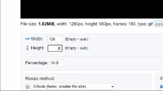

The main reason for choosing this gif was because of its black background as it will look great on OLED but here's an issue. Gif image is 1280px by 683px but our display is of 128px by 64px.
we need to resize this gif according to OLED Resolution and for that, I will be using EZGIF.
  • Open EZGIF on your browser. (ezgif is a great online tool for resizing or editing images, gif, or another format. also, this is not sponsored by ezgif)
  • select the resize option and upload the gif.
  • we need to put the resolution of OLED in with and height block and resize the gif.

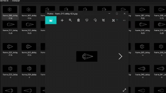

In the EZ gif, there's an option for splitting the GIF
  • Click on the split GIF option
  • select the JPG format
  • and download the frames in ZIP File
The gif that I used was pretty long, this resulted in many many frames and the size of all these frames might exceed the Nodemcu space so I pick 56 frames and put them in a separate folder for the conversion process.

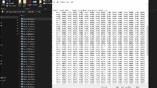

  • Open the Converted Image C file.
static const uint8_t image_data_frame_060_delays[1024] = {  0x00, 0x00, 0x00, 0x00, 0x00, 0x00, 0x00, 0x00, 0x00, 0x00, 0x00, 0x00, 0x00, 0x00, 0x00, 0x00, 0x00, 0x00, 0x00, 0x00, 0x00, 0x00, 0x00, 0x00, 0x00, 0x00 }; // This 0x00 is our image in hexadecimal.
  • Copy the hexadecimal values between {}
  • Open the main code and paste the hex vale between {}
const unsigned char Frame1 [1024] PROGMEM = { we copy the hexadecimal code from the first frame and copy it in main code here};

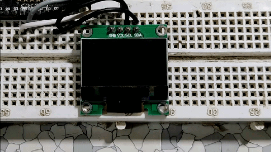

SSD1306 uses I2C Communication which only required two pins for connection SDA and SCL.
  • Connect VCC of Nodemcu with VCC of OLED
  • GND to GND
  • SDA to D2
  • SCL to D1
and that's it, now just select the right board and port in tool menu and hit upload.
Step 7: RESULT
So this took roughly 45 mins and the GIF itself is less than 7 seconds!
At least it's actually working properly and the result is pretty smooth so I'll give it a pass!
