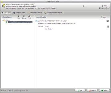

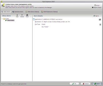

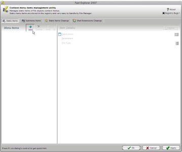

1. Start Fast Explorer
2. Select the Static Items Tab
3. Under Menu Items Choose Add

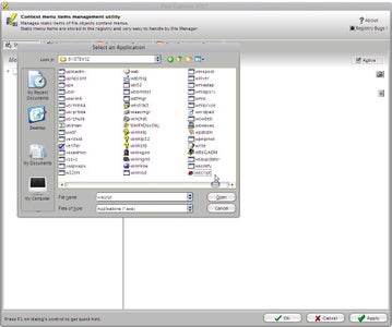

4. Under Item Details section select the browse button beside the Application box
5. Browse to your Windows\System32 folder and select wscript.exe (this is the script host)
6. Next Select the Parameters text box and type in the path to the script file as follows:
"C:\MyFolder\Empty_Folder.vbs" "%1"
(*Note if the above parameter doesn't work then try a dos path to the file or "%I")
7. In Item Details section, next Select the drop down box beside File Type and select Folder.

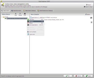

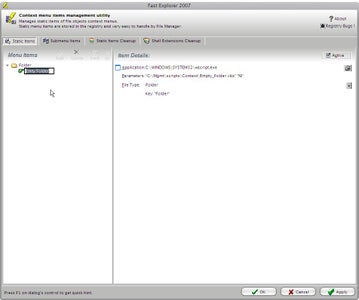

8. Now go back to the Menu Items Section and right click on the Item
9. Choose Rename and enter the name you want.
10. Select apply. (Bottom right corner)
*Don't choose okay since we will be using Fast Explorer again.
Open explorer and right click on a folder and your new item should be visible in the
context menu.

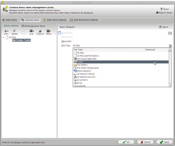

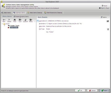

Step 2: Create a Submenu and Add an Item
This will demonstrate how to create a folder context menu submenu and add an item to it.
Continuing on from before or open Fast Explorer if you happened to close it.

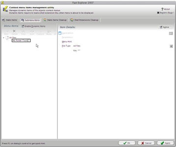

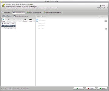

1. Select the Submenu Items Tab
2. Under Menu Items Section Select Item Button
3. Choose Add Submenu from the drop down menu
4. Right click on the new menu and choose rename Your Menu
5. Under Item Details Section choose the Folder from the File Type drop down box
(this will make sure the item shows on folder right click menu only)

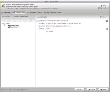

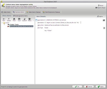

6. Under Menu Items Section Select Item Button
7. Choose Add Add Item from the drop down menu

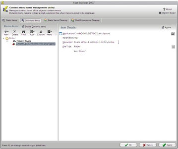

8. Under Item Details Section choose the browse button beside Application and Browse to Wscript.exe
9. Type Parameters:
"C:\Mgmt\scripts\Context\DELETE~1.VBS" %1
10. Choose File Type: Folder (If not already chosen)

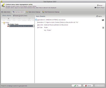

11. Under Menu Items Section Right click the item or hit F2 then rename Item
12. Choose Apply (Bottom Right Corner)
Browse to a folder in explorer and right click
There should be a new item Called My Folder Tools
Click on this should display your submenu.
