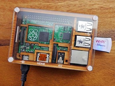

Introduction: Running a Raspberry Pi Wi-Fi Bridge
A Raspberry Pi Wi-Fi bridge is one of the best ways of providing internet access to a device that only supports an Ethernet connection.
In this tutorial, we will show you how to setup a Wi-Fi bridge using network manager on your Raspberry Pi. Network Manager is a useful tool that makes managing connections a straightforward process.
You will need to keep in mind that you will not see speeds as good as what you would with a direct connection to your router. As there is some overhead with the connection having to run through the Raspberry Pi.
This bridge allows you to easily share your Wi-Fi connection with any connected ethernet device. Thanks to Network Manager, this whole process is made relatively easy.
Remember to do this tutorial you will need either a Wi-Fi dongle or a Raspberry Pi 3 with the inbuilt Wi-Fi module.
