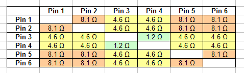

I started typing motor details into Google and identified the one as being a 12V stepper, but the datasheet is very limited. From the 6 pins I realized it has to be a Unipolar motor. I started testing the resistances between the pins and realised that the 2 centre taps are connected together.
Since my driver has a H-Bridge I need a Bipolar configuration and started investating if the two centre taps are joined internally of externally.

Looking at the external PCB i noticed Pin3 and Pin4 are joined together. This was very good news since I could simply sever the track on the PCB to create two separate center taps.
Step 2: Separating the Two Center Taps
I got a good sharp knife from the kitchen and cut the track joining Pin 3 and 4. I tested the resistances afterwards and it seems my operation was a success!

Coil A of 8.1 Ohm between Pin 1 and Pin 2.
Coil B of 8.1 Ohm between Pin 5 and Pin 6.
