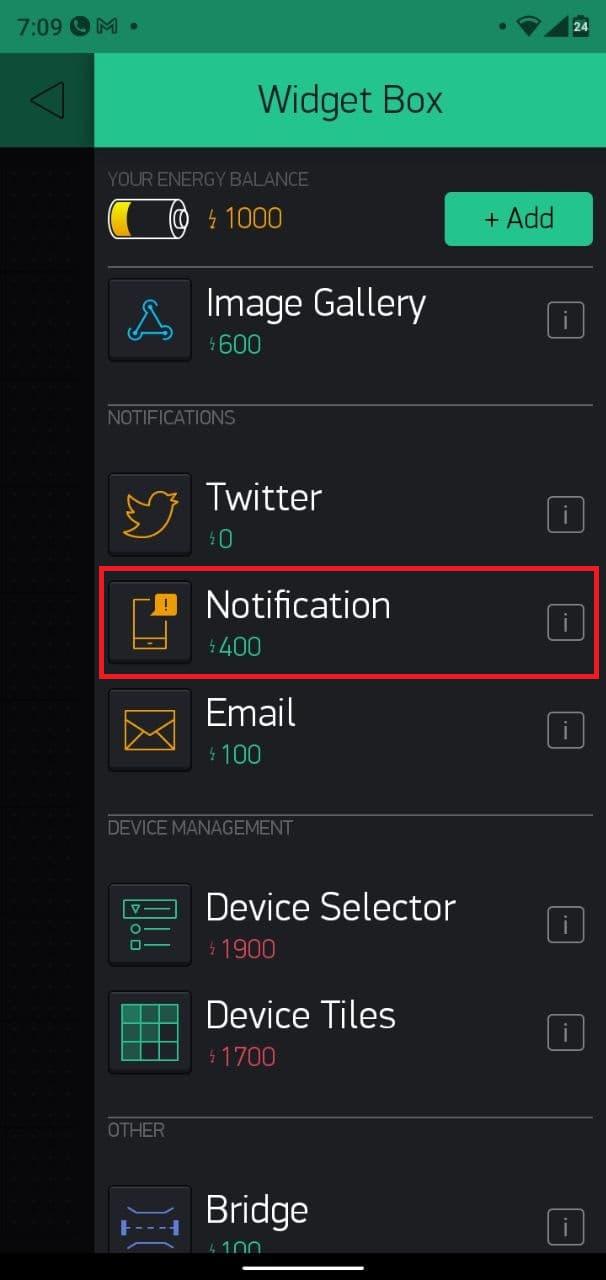

Working is simple, As PIR sensor detect motion it send signal to your Blynk app through cloud (Internet connection is required at ESP-01 WIFI module side) and you get notification (if your internet is ON) “someone outside!!!!!!!!” it can be modified which is given in coding part.
Step 3: Setting Up Blynk and Esp-01

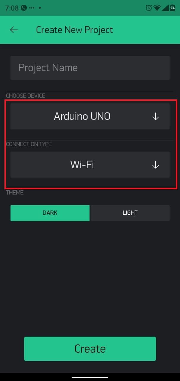

Install Blynk App and follow the instruction given in the images above
In Blynk app create new project and Select Arduino and WIFI

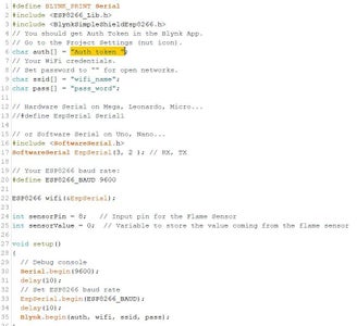

Then you get a AUTH token At registered Gmail address simple put in code and Add your wifi credentials
and upload it to Arduino
(you will need Blynk library for this project all files and library is given in files section down bellow)
