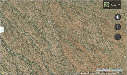

Step 1: Picking a Location

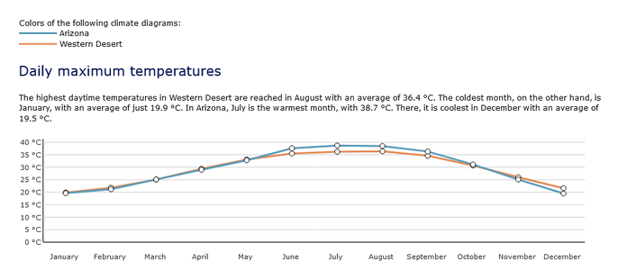

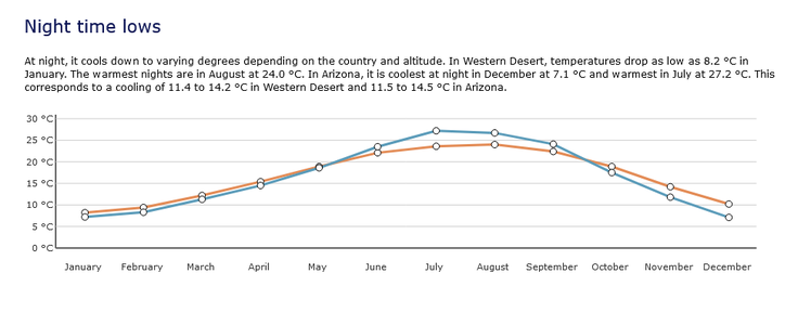

This is the location that I have specifically targeted. While it looks green, this picture was probably taken in the spring near the monsoons: For most of the year, everything is dry in Southern Arizona. In fact, this Semi-arid region of the country is only "semi"-arid because of it's average rainfall; Arizona has a yearly average of about 7 inches per year. In fact, Arizona has a higher temperature average during the day and a lower temperature average during the night compared with Egypt's Western desert. In other words, you not only have to protect yourself from frying, you also have to protect yourself from freezing. Arizona has a yearly range from 10 degrees to 120 degrees. In addition to Southern Arizona's varying temperature thought the year, this Southern Arizona also exhibits other challenges to inhabitants of this area, ranging from drought to floods, dust to mud, fires to high winds, and the ever present sun. Other rare conditions are hail and snow. A greater obstacle to the inhabitants of my habitat is that this area is isolated: it may take over an hour to get to the nearest house, either by walking or driving. It also has very rough roads that would put a lot of wear and tear on any vehicle. Because of this it is uneconomical to buy food from town, and impossible to work there. Thus, it is essential for inhabitants of this habitat to be self-sufficient, producing everything that they use, with few exceptions. This includes producing their own food, gas, power, and water. I picked this area for multiple reasons. One reason is that it is near my house, so I have experience in the climate of this area. Another reason is that as I was considering the perfect location, I went outside and was instantly convinced; June temperatures are miserable, even in the shade. This is because it gets hotter right before it rains, and the humidity also dramatically increases.

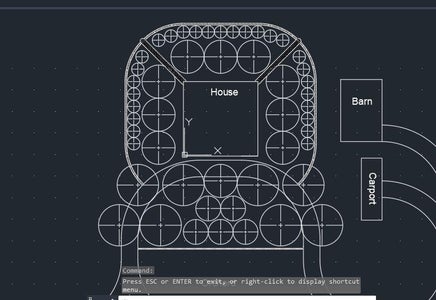

Step 2: Trees and Grass
A barrier of trees is integral to my design as they reduce the temperature during the summer, and increase the temperature during the winter. Trees also keep water in the ground and stop cold winds from blowing across the house and stealing warmth from the side of the house. Essentially, I am using the resources provided to reduce the extremes thrown against it. Also, trees provide a good source of smoking wood, as well as fire wood, from branches pruned off yearly that also create a healthier tree. The biggest trees in the far left picture are Pecan. These giants provide top notch smoking wood and are a good source of nuts. These are also used for shading the road. The second largest, making an inverted U around the house, are Oak. While these trees are slightly smaller and don't provide nuts, they are an excellent choice for a lawn; their wide-spreading branches provide shade for grass to grow vigorously. The next smallest, mostly in front of the house, are Mesquite. While many call them bushes, the trees have a very strong root system with wide-spreading branches, and they are excellent for lawns. These trees are also ornamental with their unique soft turns of their strong trunk. Their wood burns hot and long, is sought after for smoking, and makes durable and beautiful decor. These drought-resistant trees also provide hard beans which are a source of flour and a slow burning, sweet smelling oil. The smallest trees are sugar maple, providing not only a scenic background, but also a wind block and Maple syrup, a potential source of income. Bermuda hybrid grass is the primary ground cover near the house. It provides a soft, drought-resistant turf that is durable. Additional herbs should be placed around tree trunks, as they will provide an ornamental touch to useful and necessary plants. Mint, Oregano and Rosemary are some bushes that will look nice, but Thyme and other herbs will be needed for seasonings in the kitchen. The water usage of this area should be negligible- the annual rainfall is enough to keep the plants alive year round, and green during the summer months. The fourth picture is of our lawn with mesquite trees, clearly not bushes, during July. As you can see, not only is it decorative, it also provides shade. This area decreases by fifteen degrees or more compared to the sunny portion without grass.

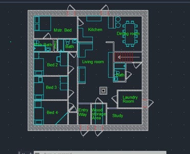

Step 8: House
I spent a lot of time planning the house for the comfort of its inhabitants. I placed the bedrooms off of the main section of the house, but I still kept them private by having a hallway that separated them from the living room. This hallway also has a bathroom attached, an attribute I find very useful in our house. The Master Bedroom has its own bathroom, closet, and door leading onto the 20' wide wrap-around porch. The kitchen is mid-sized, and both the dining room and the living room are off of it. In between the dining room and the kitchen is a bar, and the dining room can easily hold twelve people, although it would normally hold 5 to 8 people. The house can have up to eight people with bunk beds in the three other rooms, or five with one person in the three bedrooms. The wood storage area is built so that one can carry wood into the house without letting a bunch of cold wind inside, and it is also conveniently positioned near the masonry stove. The stairs which lead downstairs also have a closet. The pantry, along with three freezers, hold most of the food in storage. This is located downstairs as it has a mostly even temperature year round because the ground's temperature 5 feet down stays constant year round. (about 72 degrees) The processing room is for making different foods like jams, fruit leather, and other foods that take a lot of space. The great room is mostly just extra space that can be used for anything, such as a play room. The "cold tanks" are for storing either hot or cold water, and will be used for heating or cooling the house, depending on what time of year. (Will be discussed in greater detail later) Note: The 3D model makes it look like the rooms are small, but they are really a lot larger. Also, furniture varies from the top view and the 3D model to show different furniture arrangements. The low quality of the video is due to Autocad Architecture's low video quality recording.

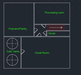

Step 13: Construction
Construction, while complicated by hard to access location, shouldn't be complicated. The basement exterior walls are built with concrete brick filled with concrete, and the floor of the basement is a concrete pour, along with the porch floor. While these materials aren't close by or cheap, they will last longer and store heat longer than rammed earth, while requiring less maintenance. However, the exterior wall of the top floor will be built with stones collected from the area around it, improving soil quality, with concrete poured in on top of it. This will be achieved by building a wooden form that is filled with rock, larger is preferred. Then, after it is filled, concrete is put in to fill the cracks. After the concrete is cured, then the form is taken off and is built again on top of the previous pour, and the process is repeated. The interior walls are made of 2 by 4's with the standard 16 inch spacing centerline to centerline, then coated with drywall after the electrical has all been wired. The roof is made with 2 by 12 with plywood on top of that, then plastic paper, then tin secured with roofing screws. Fiberglass insulation will fill the gap between the ceiling and the roof, as well as in all the interior walls. Outside, the road will have a crown with ditches on either side for drainage. Then it will be coated with AB. The barn and the other buildings will be built after the house, and they should be pretty simple. The trees, however, should be planted as soon as possible so that they have as much time to grow as possible.
