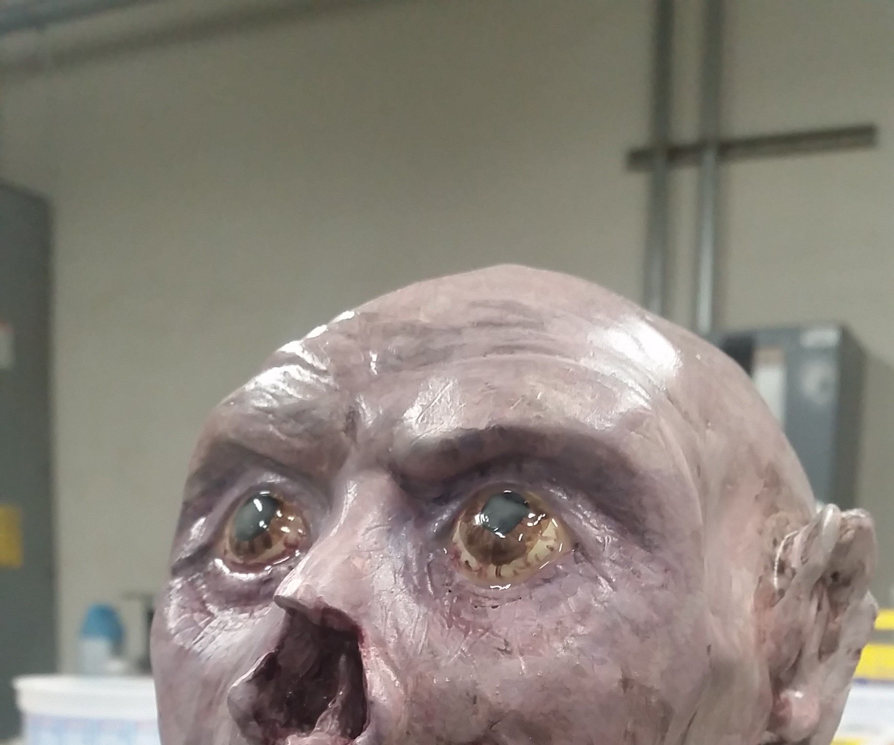

Step 3: Getting a Head, for Russel.
On to the head. This was one of my more perplexing parts of this job, and not for the reasons you might think! The heads dimensions! For the body, I just cut all my own measurements by half. This works for the body but not the head. Children's bodies are smaller but their heads are not all that much smaller than that of adults. Our eyes are the same size from birth to adulthood; our skull develops and grows around them. So their heads are smaller but not by as much as most of us might think. The zombie head I did for "Making a silicone jacket mold" was originally for this project but after putting it on the body instantly knew it wasn't right. After getting measurements from my goddaughter, I realized how off I was and those cheap plastic skulls they sell for Halloween were just about right on the money. So I hot glued the skull to a 2" x 2" stick and mounted it to a board and started sculpting. I used Roma plastilina clay to sculpt the head with the glass eyes set in place. The head might be a little larger but no one is complaining. After I finished the sculpt; a plaster mold was made. Then three layers of a suitable RTV silicone was brushed in to make a skin. In between layer 2 and 3, I embedded a layer of pantyhose material for strength. The mold was in two halves so before bonding the silicone halves together into one skin; three layers of fiberglass cloth and resin were laid up into both halves. When the resin dried I pulled out the fiberglass parts but leaving the silicone still stuck to the mold. Then the fiberglass parts are trimmed and glassed into one piece. Now the skin is bonded together with more silicone. When the silicone is cured you will have a one piece rubber skin you can pull out of the mold.
