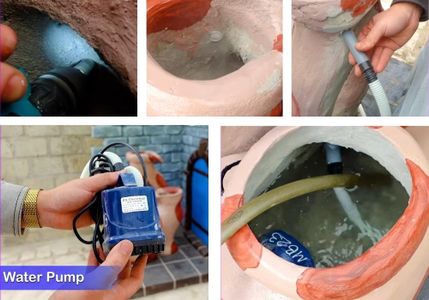

Step 6: Installing Water Channel and Pump
  • Using a drill machine made a hole in the neck of the shortest pot. This pot will hold the pump and will be the water collector and supplier.
  • Make another hole from the back of the tallest pot near the neck.
  • Connect the two pots using a bending pipe (we used a waste pipe).
  • Connect the submersible water pump with and submerge it in the short pot.
  • Fill the pots with water and make sure the pump is submerged fully.
