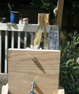

I finally decided I needed to make my own rope. I made a machine that would do all the twisting using small strands of sisal twine. I plan on making a different machine that I will post an Instructable but he one in the pictures I made quickly because I was anxious to get done and post this Instructable.
The basics of the machine is to string several strands of twine between three hooks on one side and one anchor point on the other side. The three hooks on geared to a hand crank the will twist the strands together tightly. With a guide to keep the three main bundle of strands separated it moves from the single anchor point down the length of the rope. Adding the twists into the three bundles of strands in one directions causes the now three larger strands to twist the opposite direction as you move that guide down the rope. Before twisting I added lamp socket and cord into the middle.
