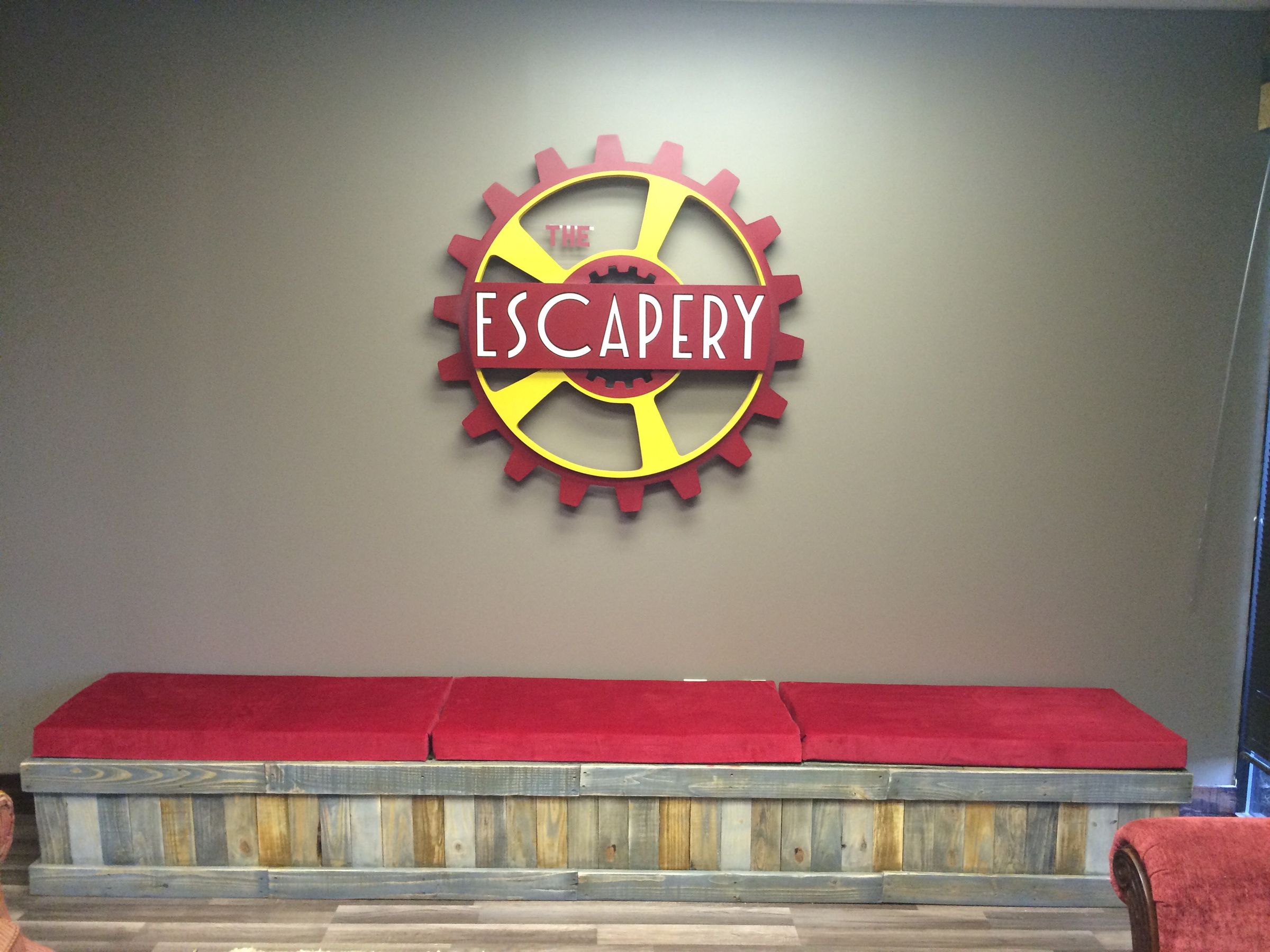

If you are creating a rustic glam look, these pallet valences are a really nice touch and pretty easy to make. We used them in the lobby of our business with red velvet like curtains and really like the look.

For this step, I simply lay down the hardboard backer and arranged the pallet wood on it (being sure to overhang an inch at the bottom of the backboard). We trimmed some pieces and created some shims to fill any large gaps to achieve the look we wanted. Then, I moved the arranged wood from the hardboard and placed it on the floor in the same order above the hardboard backer. We now used a heavy duty all purpose adhesive on the hardboard. Next we quickly laid the boards back on the hardboard in the predetermined arrangement and weighted each section for at least 24 hours (we were super fancy with kettle bells and propane tanks and other official weight devices). When the glue was dry, we flipped the whole thing over and added a lot of staples. Now the valences are ready to mount in the wall/window unless you want to make some cosmetic alterations.
