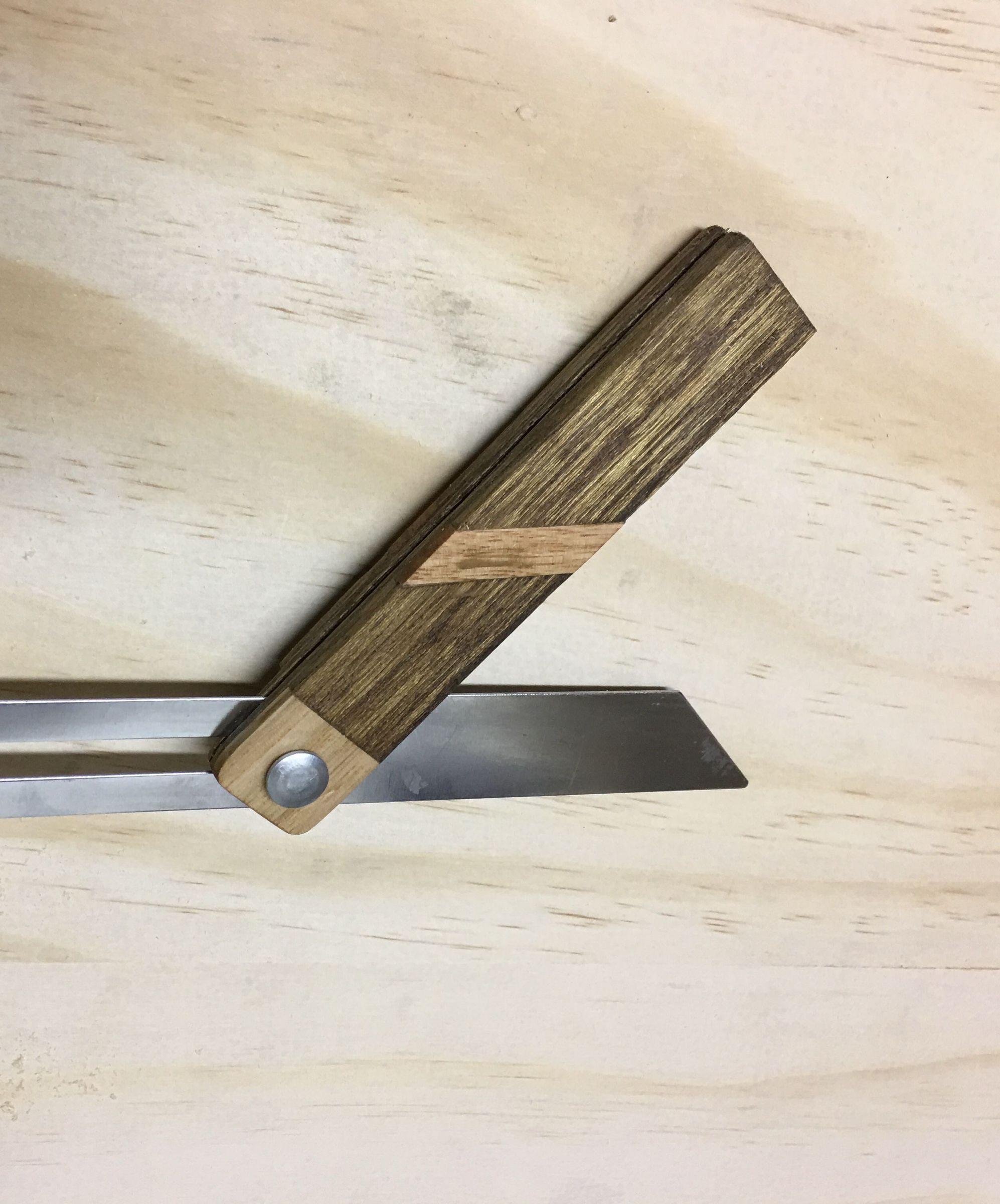

Step 2: Tools Required...
Power drill and saw, clamps, screws, set square, wrecking/pry bar and mallet, tape measure. Please also use appropriate safety gear and take care while you are using a circular or powered saw. I recommend grabbing a whole bunch of long shanked exterior grade screws for putting it all together, plus maybe a countersink bit for getting the screw heads nice and flush
