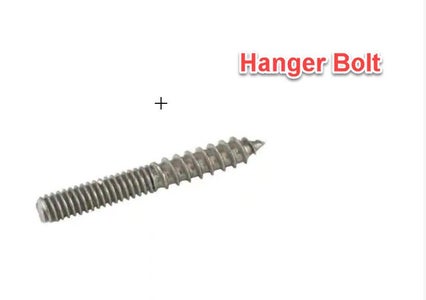

Hanger Bolt Knock-Down Method
The drawings show how the screw-thread ends of two 5/16" "Hanger Bolts", also found at most hardware stores, could be permanently installed in the top and bottom of the Post at 2" O.C. and the threaded end left protruding about 1 1/4". Using two bolts, instead of one, prevents the Post from spinning on the Foot or under Tray #1. There is a hybrid method that could be done (not shown) where only one Hanger Bolt is installed at the center but then the end-grain of the Posts would be tenoned (same as the Traditional Mortise and Tenon Method above but with a much shallower tenon) and then a matching mortise placed in the Foot and Tray #1. This mortise/tenon connection, even if shallow, will prevent twist.

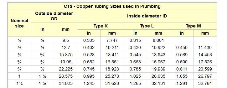

Tapping the Copper to Attach Tray2
While on the road, due to lack of certain tools and access to materials, I deviated from the original joinery method of attaching the two trays to the Post. You will see in previous videos I bought some copper plumbing parts and then epoxied those to Tray 1 when pouring the clear-coat on the table. This worked great to hold the copper to Tray 1 permanently but then that copper got in the way of the long bolt that was supposed to have gone down to the threaded tenon on the Post. Eventually I saw the error of my ways and figured it best to simply wait until we returned home where I'd have the tools and materials to fix it.
When home I drilled a 17/64" hole in the copper and then threaded that hole with a 5/16" tap. This process and the results are demonstrated in the video below.
Video: Joinery Fixes Made After Return Home
New Mortise over Old Mortise Via Template Router
