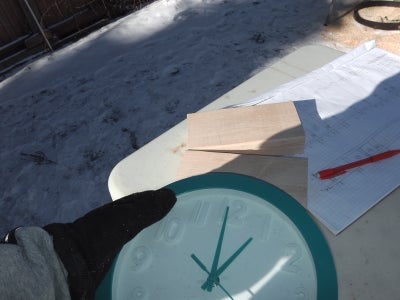

Step 4: Cut the Curves in the Middle.
These are the curves for the pieces labelled 'D' in the cut list, it is also not necessary to cut the curves so if you choose to leave them as just squares then make sure to size the plywood appropriately.
To get a curve shape, I just found a roundish object about the right size, which in my case turned out to be a wall clock, other ideas would be an ice cream lid, or large honey container. I then used a jigsaw to cut the curve itself.
In the pictures and videos you'll see that I cut the dados (future step) before the curves. This was a mistake, as it was difficult to hold onto the small pieces of wood while using the jigsaw (which you might notice in the video). In retrospect I would have probably cut the curves while the wood was still part of it's original 2x4 (1.5" x 3.5" effective), then cut into it's components, and then the dados.

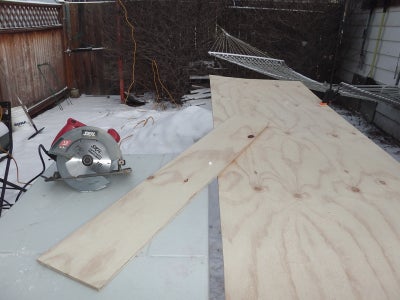

Step 5: Cut Plywood Insert Pieces for Side Assembly
Next, it's time to measure and cut the plywood pieces for the sies.
This is probably the easiest part, start with the largest pieces first (in our case 'H'), and then move down to the smaller pieces.
I used a circular saw to cut the plywood in fairly straight lines, and because there is some flexibility for how the plywood will be put in the dado grooves then we don't need to be worried about the blade width. This gives us the freedom to measure everything at once, cut it all at once, and not need to worry about 1/16" or 1/8" issues later.

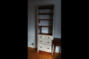

Step 11: Glue and Assemble the Structure
At this point we have assembled sides, and we have the cross pieces for the middle, and we've dry fit them.
Similar to the sides, we work our way down. However, this time we're using screws (nails would also work), so while we're still gluing, the screws will hold the wood together eliminating the need for clamps. You'll notice in the video that I still sometimes use a clamp just to hold the wood together more easily while screwing.
In my case I just screwed in directly with no countersink, if you'd like a cleaner look you could drill a countersink first, then screw, and then cover up the screw with a dowel (which I did not do).

There are a lot of ways to make drawers, but since I'm in the mood for using the table-saw, we'll come up with a quick design that will leverage dado grooves and work with our thick drawer fronts. Since our front is so thick we're not going to make a false front, and instead have the drawer front join directly with the rest of the box.
I'm going to use 3/4" plywood only because I have a few off-cuts available from a previous project. Otherwise, a smaller thickness would be fine ( 1/2" is more typical). The plywood I'm using is also pre-finished, which is unnecessary for the boxes (since they're never seen except when pulled out you can use rough cuts). I need the space back in the garage though that these sheets are taking, so off to the table-saw they go.
For the small drawers at the top I'm going to have the sides and the back almost the same height as the drawer front.
The middle and bottom drawers I want the sides and back to be smaller, and for simplicity I'll have the sides and bottom of the middle and bottom be the same (even though the fronts are different sizes).
For the bottom of the drawers we'll use a much thinner plywood, where the choice was made solely based on "what is the thinnest plywood I already have, and is enough for all 4 drawers".

Step 19: Making Drawer Boxes: Cutting the Basic Shapes.
Before using the table-saw, make sure your blade is back at a 90' angle. I didn't re-check this time, the blade had shifted slightly, and I didn't notice until I was assembling the drawers. It wasn't enough to cause an issue but it made the boxes slightly less perfect square cuts than they could have been. If I weren't making a 'rustic' style I probably would have redone the cuts.
The pictures demonstrate progression of just the shapes, following the cut list on the previous step.
When finding wood in the scrap pile, I organized it such that the top drawers would have the same height for the sides and back. However, when I got to the middle and bottom there wasn't exactly enough wood to have the same height in the back and the sides. Since the back is rarely seen, and it won't cause a structural issue I decided to just split the wood that I did have in half. You'll see in the later videos this size discrepancy.

There isn't much excitement in this step, the sanding took about as much time as the cutting of the grooves.
It is however, very, very chilly (-18 degrees Celsius) and has started to snow heavily. Luckily because it's so cold the snow isn't melting, and not causing damage to the wood.

Step 28: Final Assembly
This is the final step in this instructable. We put the top back onto the bottom, screw it together, anchor to the wall.
Materials:
  • All pieces from previous steps.
  • 1 3/4" screws x qty 6
Tools:
  • Screwdriver
Steps:
  • Put the top on the bottom.
  • Screw the top piece into the bottom piece (using pre-drilled holes)
  • Add the drawers and shelves.
  • Test fit with the Buffy books.
  • Anchor to the wall
Output:
  • Satisfaction
Please always remember to anchor bookshelves or other tall furniture to the wall, this will help reduce the likelihood of accidents such as children climbing and pulling it on themselves.
