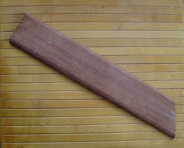

As I mentioned in the introduction, I had a lot of Angelim Pedra to work with. Ironically I only had two broom sticks to work with. Since I wanted to make four of these towel racks, and the broomsticks measured about 100 cm each, I decided to make my racks about 50 cm wide.
The first picture above isn't the exact piece of wood I used, but from the same wood pile.
(This is a piece I used for my Steampunk Socket/Switchplates;-)

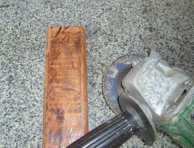

Step 2: Grind (or Sand) Wood
This wood is particularly hard, and as I learned in making my steampunk switchplates, it lends itself nicely to being finished with a grinder. The grinder adds a nice rustic effect, by leaving burn marks on the wood. If you don't have a grinder, or the wood you use doesn't lend itslef to this process, you may decide to just sand your wood.
This is also a good time to drill two holes through the base, equidistant from each end, where we will later mount the rack to the wall.

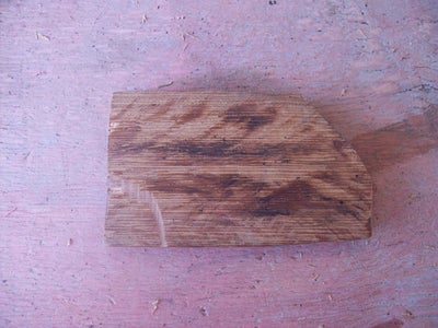

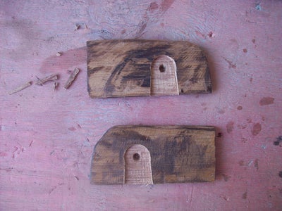

Step 3: Cut End Pieces
To create the ends of the towel rack, which hold the broom stick in place, measure how far out you want the towel to hang, keeping in mind that that you'll lose a bit of space when you attach these pieces to the back.
After you've cut two rectangular pieces (about 4 to 5 inches long) make diagonal cuts on the top of the ends that will face out, and then round the edges a bit with a sander, rasp or file.
(The picture above is of an end piece that I cut too short, but you can see the rounded edge).

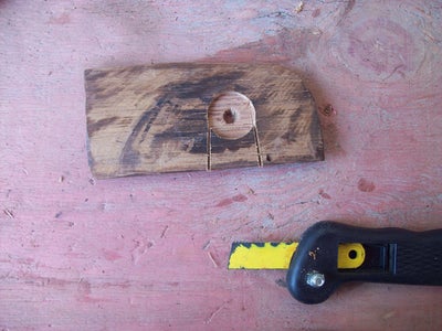

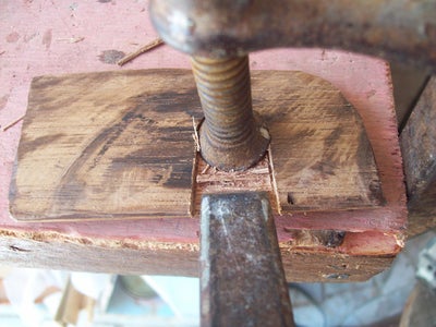

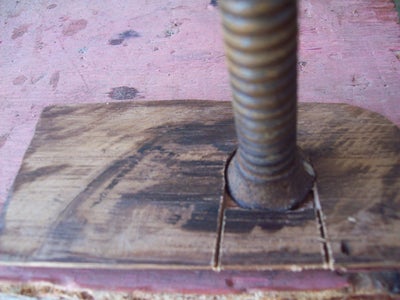

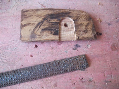

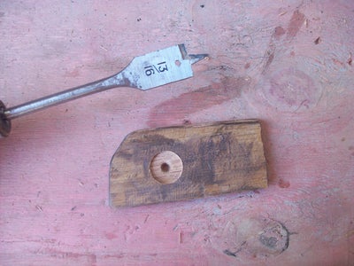

Step 4: Prepare End Pieces
This is by far the most complicated and labor intensive step in this process.
I thought about different ways to assemble this rack, and realized I needed to mount it to the wall before I added the broom stick. (Otherwise the stick would interfere with screwing into the wall). To accomplish this, I decided to prepare the end pieces in such a way that I could slide the stick in after the rack was mounted. (Why does that sound so dirty?;-)
So what I did was use a 13/16 wood bit to create the hole. I drilled just far enough to create a small hole through the other side, to eventually put the screws which will hold the stick in place.
Then I used a hack saw blade to make slits from the drilled hole, to the bottom of these pieces, making sure that the space was slightly wider than the holes.
Once these guidelines were cut into the wood, I placed the piece in a clamp, placing the clamp upside down. The bottom part of the clamp I used fit perfectly into the drilled hole, and held the piece in place, while I chiseled out a track to slide the broom stick into.
After chiseling, I used a rasp to smooth out the slots.

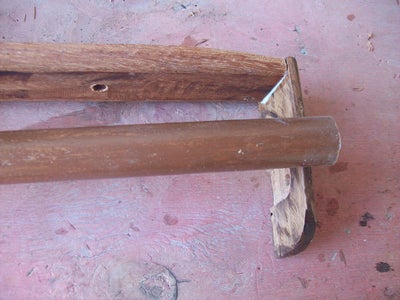

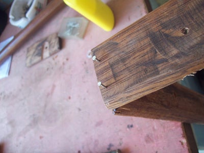

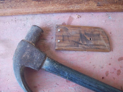

Step 5: Assemble
With the end pieces ready, it's now time to nail them to the base. Start hammering the nails in place before assembling. Once the nails are in the end piece, place some wood glue along the edge of the base and then nail on the end piece.
As the wood I was working with is particularly hard, I didn't have to worry about it splitting, but you may have to find another way to attach the ends (maybe elbow brackets or hinges?) if you are using a more delicate wood.

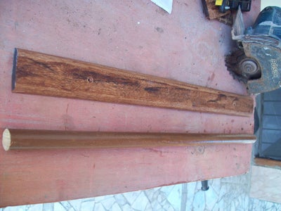

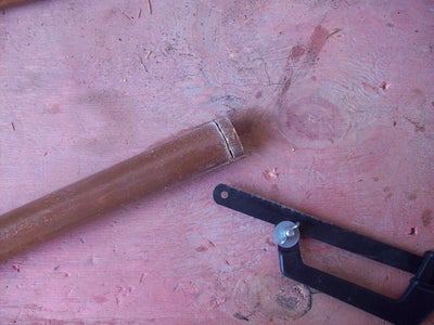

Step 6: Paint and Cut Broom Stick
I forgot to take a picture of the broom stick before I painted it, but it looked just like a broom stick!;-)
I used a coffee colored (if you take your coffee with milk) enamel paint, which in Portuguese is called "Tabac," I guess because it has the appearance of dried tobacco. Select a paint color depending on your desired finished product.
Once the rack is assembled, lay the broom stick in place, and measure to make sure you have a tight fit, inside the end pieces.

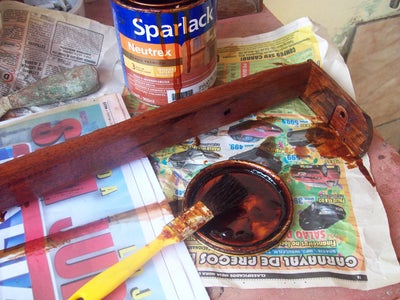

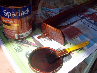

Step 7: Varnish (or Stain)
I used a Brazilian varnish called Sparlack Neutrex, the same varnish I used for my Instructable, Painting metal to look like wood.

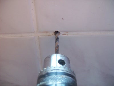

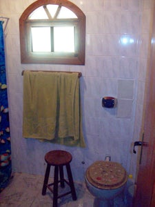

Step 8: Mount Rack to Wall
If you have tiled walls, you probably want to drill a hole first, and install plastic screw anchors.
Measure the distance between the holes by placing the rack against the wall, and making marks (maybe with a nail or screw) through the holes in the wooden base. Once you have the plastic anchors in the wall, you're ready to mount the rack.

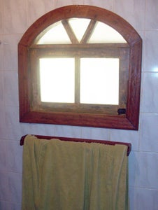

Step 9: Finished Product
Unfortunately I forgot to take pictures of the last step, which is screwing the broom stick into place. But if you've made it this far, hopefully you can figure out the rest on your own!;-)
