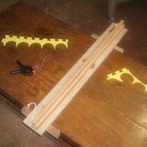

The foot that holds down one's work, and other parts are made out of PVC plastic. PVC can be heated to form it. Be careful not to burn it, to avoid toxic fumes. I use either a gas stove or a propane torch for heating.

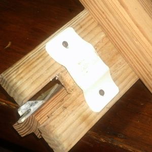

The saw slides forward for removal from the wooden frame. The frame has two pieces of 2X4 screwed to it that bracket two sides of the work table. The clearance is tight and all it takes is a small PVC wedge in the crack to lock the frame firmly to the table.
On the bottom side of the frame is a PVC piece screwed to the wood that applies pressure to the saw housing. That holds the metal base plate of the saw firmly against the wood on the other side and keeps the saw from vibrating up and down. The foot that holds the work down keeps the work from vibrating up and down.
