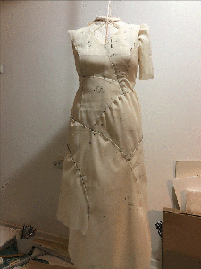

Step 3: PATTERN DRAFTING
Now the muslin can be shaped and pinned to onto the crinkled paper and the dummy.
There are plenty of tutorials on how to draft a pattern from scratch, or you can get creative. For example: use an existing dress that you like and drape on it. If you can cut some old dress, even better, just make sure that you draw the intersection lines of the patches.
Add notches and naming for easier assembly.

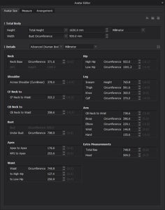

Step 4: PATTERN MADE IN CLO
CLO is a pattern making software that was downloaded just for this project.
The pattern was made for specific measurements which are added in an image as a reference. So, you can print it and make the changes for your measurements.
The pattern was never tested, and it was created as a guide. There are 15 pages of a big A3 format paper.
IMPORTANT: The pattern is without seam allowances.

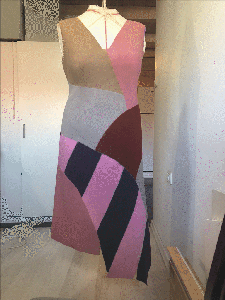

Step 7: CUTTING
The pattern was cut with only two places for the seam allowance - the zipper and the sleeves.
Step 8: SEWING IT ALL TOGETHER
Just make sure to place a zipper if you are sewing a snug fit.
