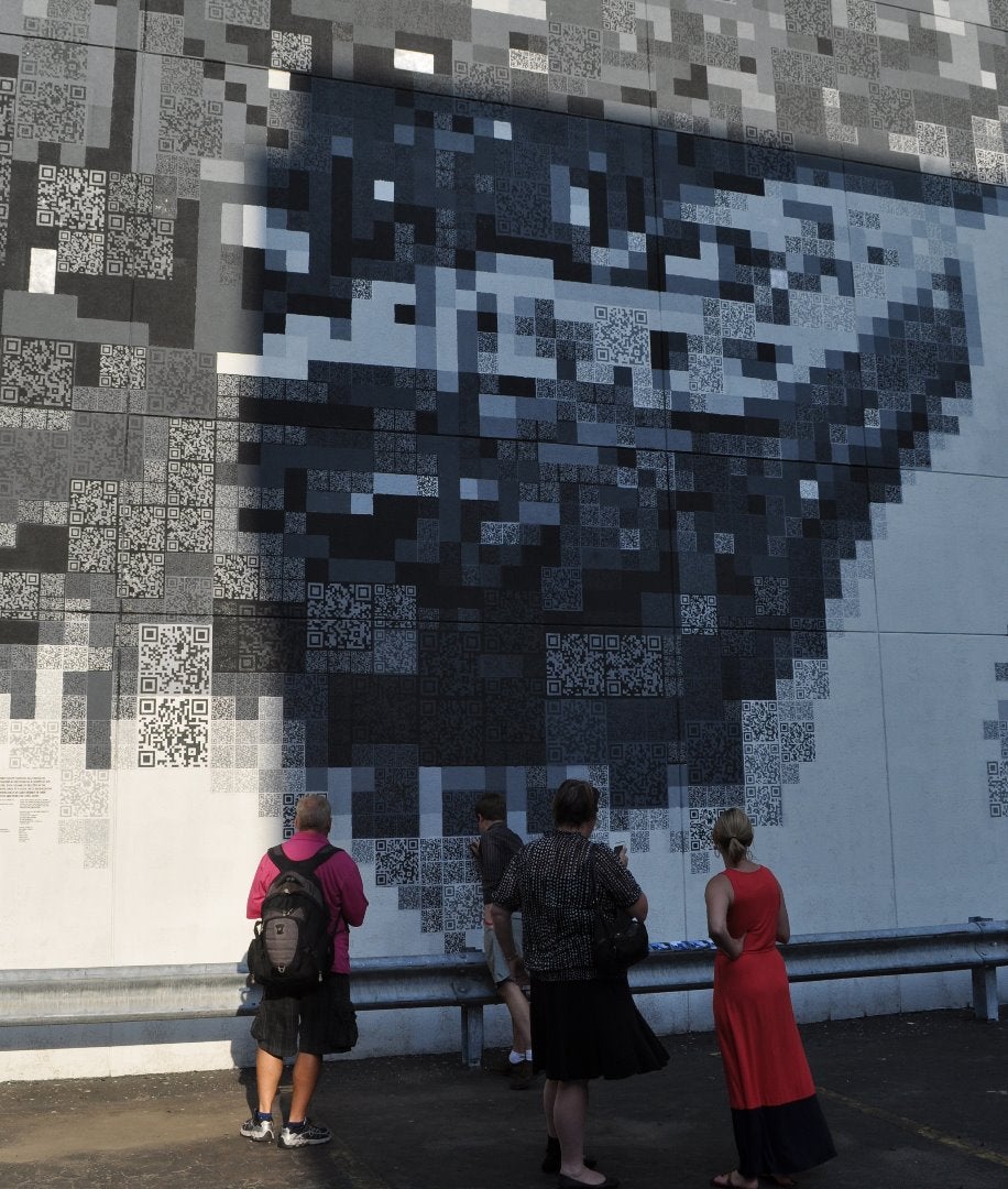

S.Alt City is a mural for downtown Syracuse that simultaneously celebrates Syracuse’s industrial past and its current status as an artistic hub. At first glance, the image is historical, depicting a pump house and brine distribution center. On closer inspection, viewers realize the image is a mosaic composed of dozens of unique QR code tile, each linking to a contemporary arts organization in the greater Syracuse region. How did we make this project? Follow the steps below to consider how you might make a similar interactive QR Mural

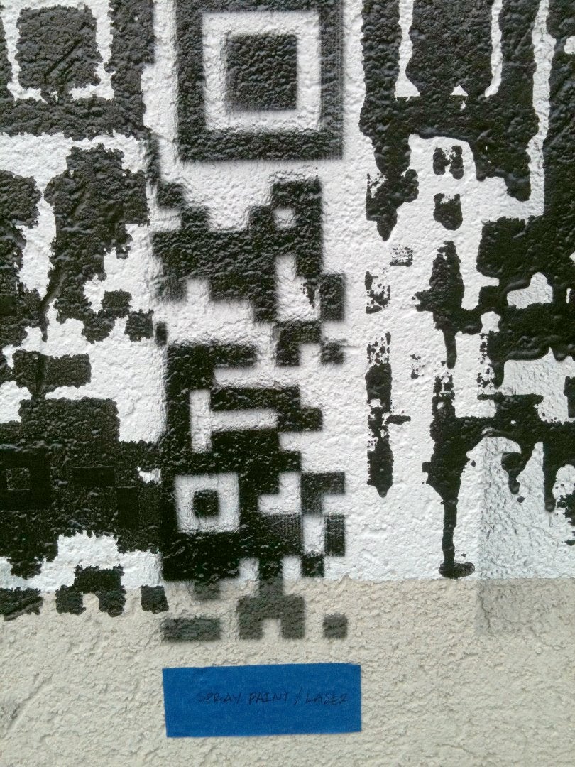

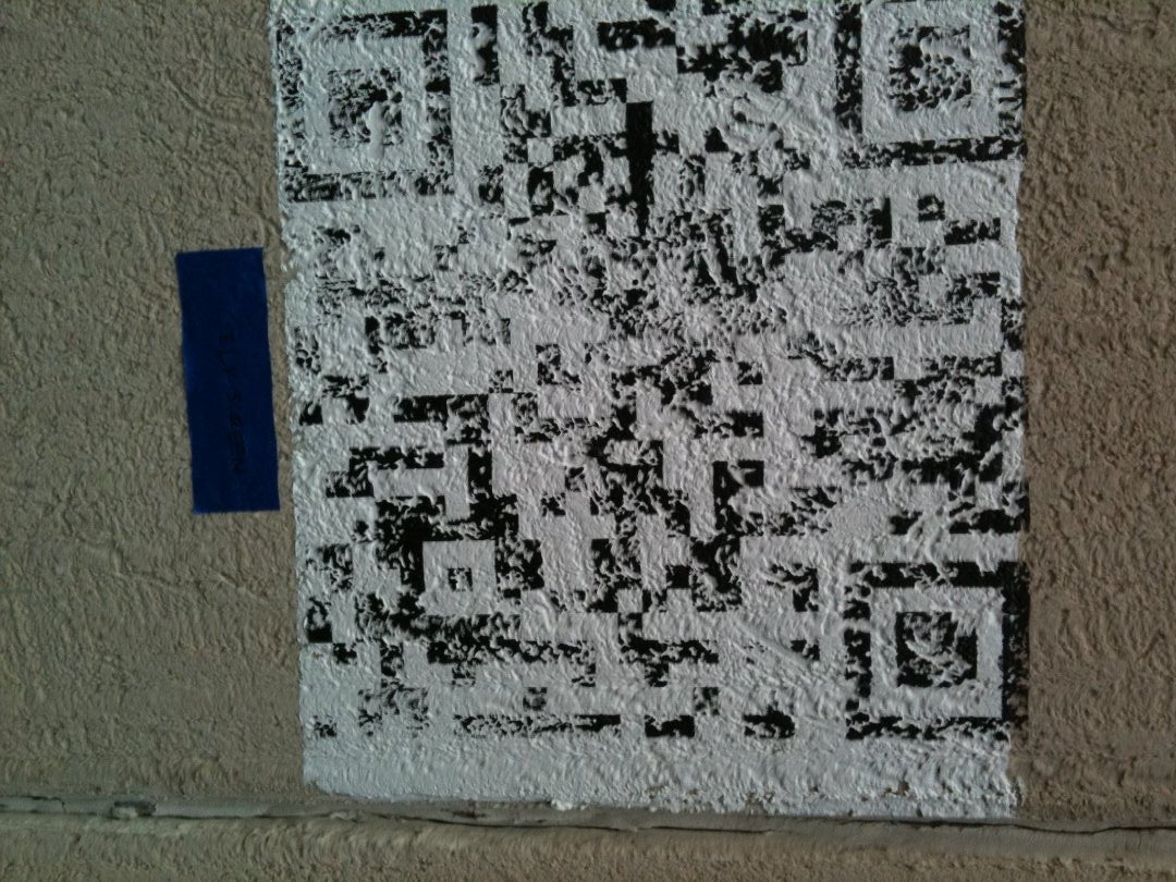

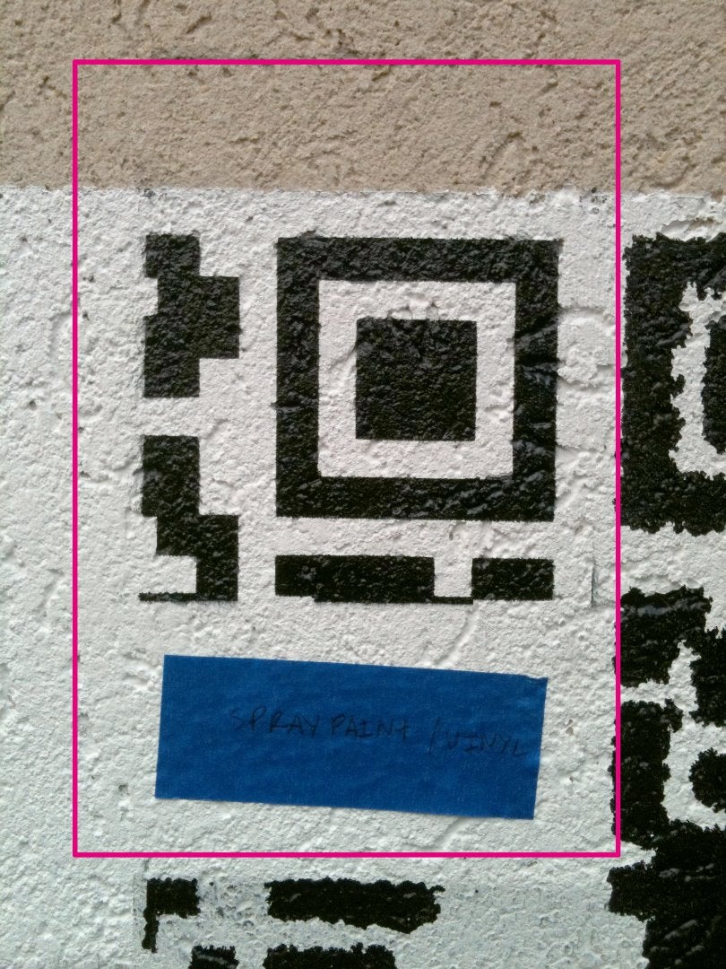

Our next step was to test various painting techniques. QR code needs to be fairly clear, with approximately 30%contrast to be readable with most of the phones we tested. We did a series of paint tests just to see how articulate we could make the paint edges. There were two competing goals: making the QR codes as clear as possible while allowing us to paint as fast as possible. Tests included various laercut materials as well as what we ultimately chose: a vinyl cut template that was temporarily rubbed onto the wall. Once the vinyl was rubbed onto the wall, we painted it with spraypaint and finally removed the vinyl. Other painting methods such as painting with a roller were tested, but ultimately the spraypaint over vinyl transfer was the cleanest and fastest method.

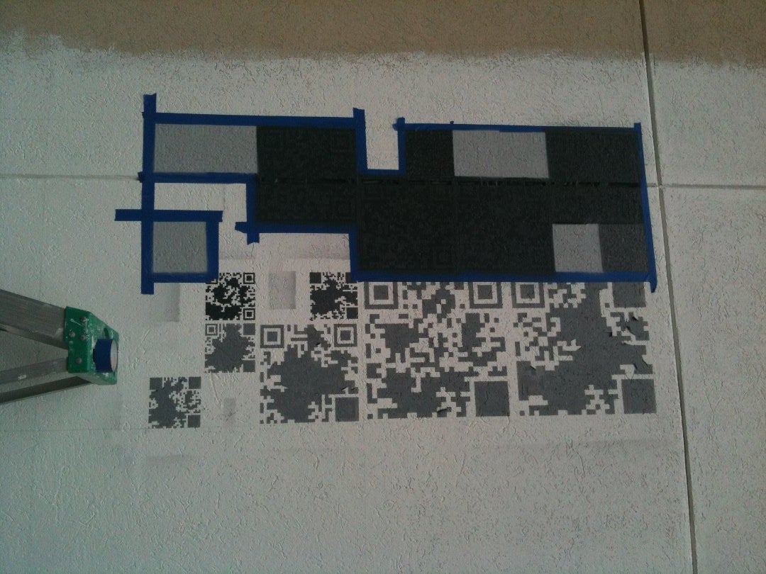

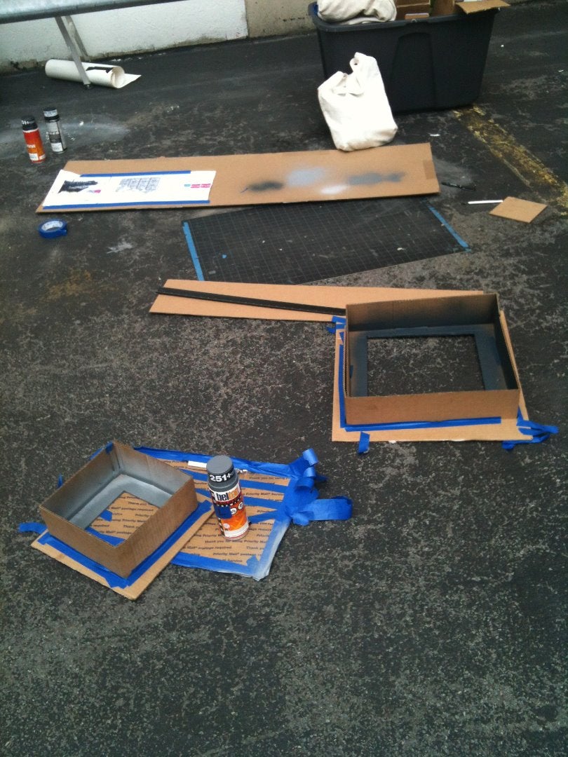

On site, we continued to test and refine our method developing an on site ad-hoc spray guardthat kept the spraypaint from going outside of the inteneded area. In the image to the right, you can see various spray tests before and after the vinyl template had been removed.

To celebrate the completion of the mural, we held an opening which brough together the many communities that were involved from the architecture school to the historical organizations involved, to the arts communities that are linked through the QR Code. One of the inventions of the project was that the QR codes, while static, have a "back end" that is dynamic. In other words, as arts organizations in the community change, we are able to change the links that the QR codes link to.
