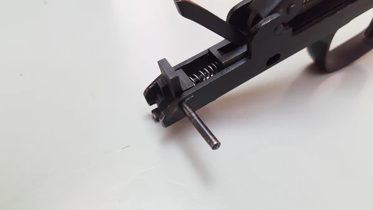

Step 2: Remove Trigger
 Remove the trigger assembly from the rifle.

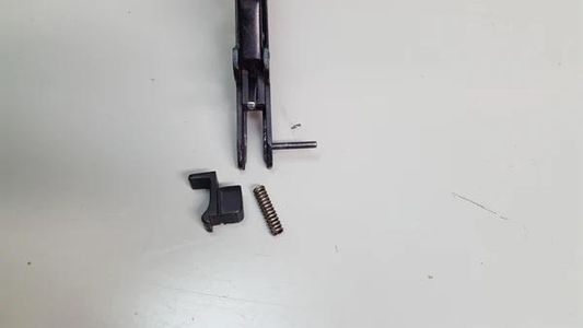

Step 3: Remove Old Magazine Release
 Remove the original magazine release by drifting the retaining cross pin out. Depending on the trigger assembly, it may be difficult to drift the pin out. The original magazine release and spring will no longer be needed.

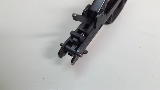

Step 4: Install SBI Latch and Spring
Install the SBI Magazine Latch and Spring. You must use the provided spring as the original will not work with the magazine release. Make sure the spring seated in the magazine latch and trigger sear holes properly. This is the time to check if any fitting will be required.

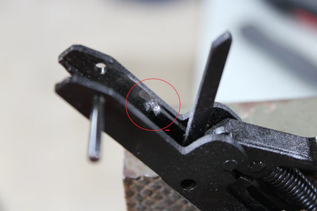

Lubricate the the latch and trigger frame rails. Add a drop of your preferred gun oil to lubricate the latch. This will make the latch operate smoother, prevent binding and protect against corrosion. If binding continues use a wire brush on a Dremel tool to polish the rails on the trigger frame. Burrs, debris, and cosmoline will cause binding.
Step 6: Chinese SKS Hand Fitting
On some Chinese SKS rifles the rails the sear slides on are milled longer than the Russian SKS. This may prevent full travel of the SBI SKS Magazine Release. To fix this you will need to Dremel or mill down part of these rails.

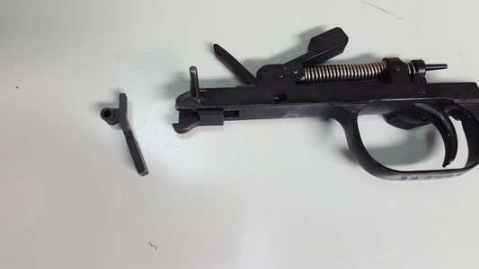

Step 7: Position Magazine Release Lever
Align and position the SBI Magazine Lever
Step 8: Install Pin
Drift the cross pin through the SBI Magazine Release Lever hole.

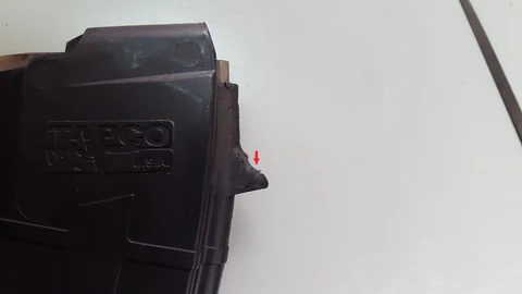

Step 9: Modify Magazines
If you are using Tapco or similar magazines you may be required to notch the top of rear magazine tab slightly for it to fully seat in the rifle. You may also need to remove a small amount of material from the rear of the tab so it clears the magazine release.
