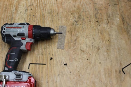

Step 3: Fit and Install Threaded Receiver Pins
The threaded receiver pins are designed to fit tight and may require hand fitting to your receiver. Test fit the pins to your receiver. If they are too snug, use a drill and sandpaper to sand down the pins to fit your receiver. DO NOT HAMMER THE PINS INTO YOUR RECEIVER, YOU WILL DESTORY THEM.
