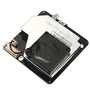

The SDS011 is designed to detect the amount of dust in the air.

  • SDS011-sensor.

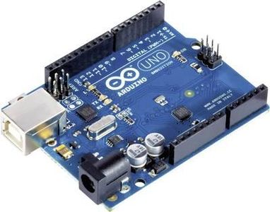

  • Arduino-board UNO 65139 ATMega328.

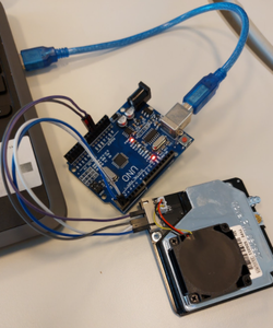

  • Connect the first wire (blue) from TXD on your sensor to RX<-0 on your arduino.
  • Connect the second wire (orange) from RXD on your sensor to TX->1 on your arduino
  • Connect the third wire (black) from ground (GND) to ground on the arduino.
  • Connect the forth wire (green) from 5Vto 5V.

Step 3: TESTING
  • Push on the arrow "Upload and save".
  • Go to "monitor".
  • If everything works well, you will see the measurements.
