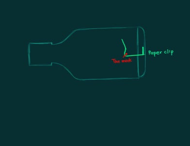

Step 9: Making the Lid
next glue the clips to the lid as shown in the image. also you have to bend it again as shown in image ti sit them perfectly inside the lid.I used epoxy glue.
give good time to cure the glue.
after glue is cured ,then insert the lid in to the upper bottle part.even the bottle is dark you can see through glass. So mark the point outside the bottle as shown in the fig 3
repeat the process for the oposit side.
Step 10: Upper Part of the Bottle
now glue the clip we made early as shown in the image. Previously marked mark must be align as shown.
the locking mechanism is now completed.the GIF image shows how the lock look like when its locked.
