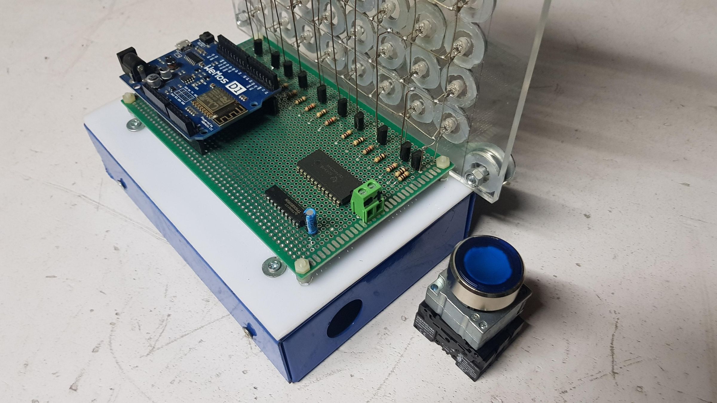

All components were soldered following to the schematic diagram in STEP 2. I did this circuit by handmade, and arranged all ICs on top side of PCB, all wires are hidden underneath the PCB.
- Soldering 10 led rows (anodes) by copper wires to PCB 9x15cm at transistor A1013 output pins and 8 led columns (cathodes) were also soldered to PCB by led pins. Resistors 1K and 100 ohm were also soldered afterwards.
- All remaining components were soldered on the PCB including Wemos female headers. We can see the top view of PCB
- And here below is bottom view
- Soldering male headers to Wemos R1 D2 at available spare holes on the board.
- Plugging Wemos onto the DIY PCB.
- Connecting the leds and control PCB to the box. I used 2 nice supports to keep the acrylic sheet firmly connected to the box. The box is made of steel so it is heavy enough to hold the led and acrylic plate from falling off.
All components are exposed when we look from backside.
