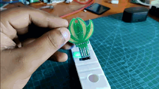

So this is the SEEED Studio Themed PCB Keychain that I made, It basically a Blinky board that looks cool when lit up in dark.
I've prepared this project in order to check the Seeed Studio PCB Service, more about that later.
This project contains 12 white LEDs that are all driven by an 8205S mosfet IC and this mosfet IC is controlled by an Attiny13A MCU.
I used Attiny13A in this project because of its cost and availability, it has five usable IO Ports and is available in the SOIC8 Package which was perfect for my application as I wanted to make a small and compact keychain without using any THT component.
As for the Design for this badge, I used SEEED Studio's official logo in it by uploading it to my PCB Cad software and preparing a custom layer with it.
This Instructables is about the whole built process of this keychain so let's get started!

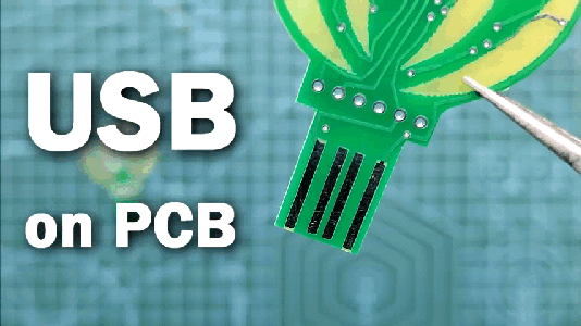

Step 3: USB PORT on PCB
Here's something super interesting, we can directly prepare a USB on PCB by making four rectangular pads and then add solder wire to each pad in order to increase its thickness as USB Port needs at least a 2mm thick board for conductivity.

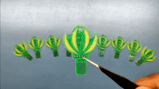

Step 4: Getting PCBs From SEEED Studio
After finalizing the PCB and generating its Gerber data, I send it to SEEED STUDIO for samples.
I received PCBs in a week and their quality was super good considering the rate which was also pretty low.
Seeed Fusion PCB Service offers one-stop prototyping for PCB manufacture and PCB assembly and as a result, they produce superior quality PCBs and Fast Turnkey PCBA within 7 working days.
PCB Quality of this joystick PCB WAS SUPER!
When you prototype with Seeed Fusion, they can definitely provide Free DFA and Free functional tests for you!
Check out their website to know about their manufacturing capabilities and service.

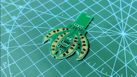

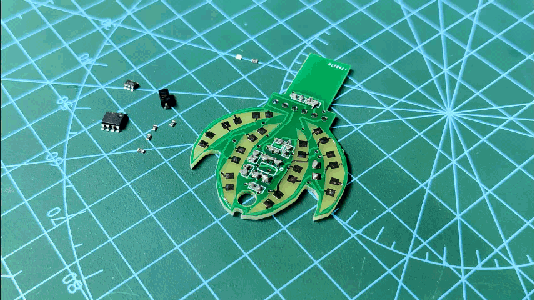

Step 5: PCB Assembly Process
These are the steps for the main assembly of the SEEED Keychain
  • Solder paste Dispensing Process
  • Pick & Place Process
  • Hotplate Reflow
  • LED Upside down Placement

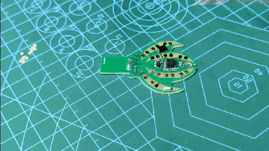

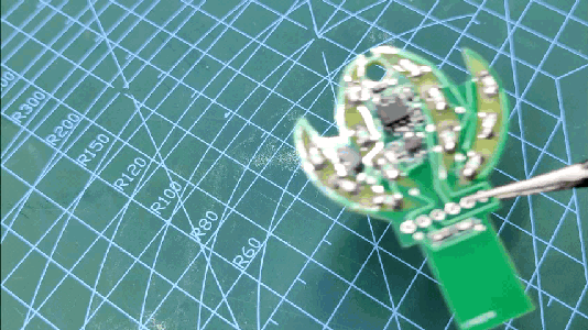

Step 6: SOLDER PASTE DISPENSING
Now the first step is to add solder paste to each component pad one by one.
To Apply solder paste, I'm using a Solderpaste Dispensing Needle with a Wide syringe, and the solder paste I'm using is a regular solder paste consisting of 63% Tin and37% Lead.
Step 7: Pick & Place Process
After applying Solderpaste we move on to the next step which is to add components to their assigned location.
I used an ESD Tweezer to place each component in its place.
Step 8: Hotplate Reflow

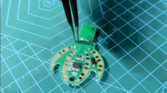

After the "Pick & Place Process", I carefully lifted the whole circuit board and place it on my DIY SMT Hotplate.
the hotplate heats the PCB from below up to the solder paste melting temp, as soon as the PCB reaches that temp, solder paste melts and all the components get soldered to their pads, we lift the PCB and then place it on a cooler surface for a little bit, to cool down the heat of PCB.
Step 9: LED Upside Down Placement
  • To solder each led, I first added solder to one side.
  • then we pick and place the LED in its place and melt the solder we just placed and it will hold the led in its place from one side.
  • we then add solder to the other pad and this will secure the led from both sides and the LED will be completely held down on its pad.
  • Now we solder the rest of the LEDs one by one by following the same method.
Precaution here is to not overheat the LED or it will melt, just be quick and use a lower temp like 280 degrees to melt the solder paste or solder wire.
Step 10: LED Testing
After Soldering all the LEDs, we test their continuity with a multimeter set on the Diode checking mode.
we place the probe of the multimeter onto the anode and cathode of any LED.
Because all LEDs are connected in parallel, all LEDs should glow, if any led is not glowing, this means there's a connection error, correct that error and move on to the next step which is to upload code in Attiny13A.

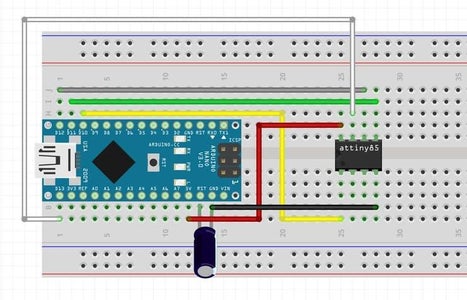

Preparing the Arduino as ISP setup
AVRs chips usually come blank, they need to be set up to be Arduino IDE compatible but to do that you need an AVR programmer do to that, for example, a USBASP.
Fun Fact, you could make your own AVR Programer with an Arduino Uno or a Nano board in a straightforward step.
  • Connect your Arduino board with com port and select Example>ArduinoISP, upload this sketch onto your board.
  • After uploading, go to the tools menu and choose the Arduino as ISP option in the programmer section.
  • Now for flashing Attiny13A, we can select the Attiny13A in the Board section.
The programming process uses VCC, GND, RST, MISO, MOSI, and SCK.
  • 5V of Arduino to VCC of Attiny
  • GND to GND
  • D10 of Arduino to RST of Attiny
  • D11 of Arduino to MOSI of Attiny
  • D12 of Arduino to MISO of Attiny
  • D13 of Arduino to SCK of Attiny
Wire the Attiny13 with Arduino in the above way. (also right after uploading ISP Sketch to your Arduino, do not forget to add a 10uf Cap between Reset and GND pins of your Arduino board)

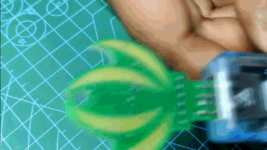

Instead of using an Arduino Nano and a breadboard for this job, I will use my DIY Attiny Programmer which I made for flashing the Attiny or Atmega MCUs.
Check out more about this Programmer here- https://www.instructables.com/Multiple-ATtiny8513A-Programmer/
  • connect the Board to the Arduino as ISP Setup in the above wiring config
  • choose the right port, right programmer (Arduino as ISP), and hit Burn Bootloader
  • wait for a few seconds, you will get done burning the bootloader message.
  • Now Open the sketch that you want to upload to this Attiny
  • Go to the Sketch menu and select Upload using the programmer.
  • and your Sketch will get uploaded onto the attiny13.

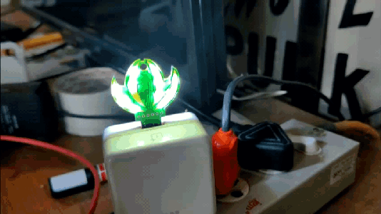

Step 12: RESULT
Here's the result of this built and the keychain is working.
This PCB has a hole in the upper section for adding a keychain or we can even add a chain to it and wear it as a fashion accessory.
It can be powered by any USB Port so we can use a power bank or any wall adaptor.
