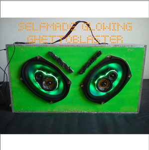

I started with this old box, which i builded 2 years ago. It's a simple wood construction with two 180W 3-way-speakers. I wanted to make something great out of it so I started collecting ideas untill I came up with the idea of building a mobile speaker.
Step 2:
I found an old amplifier, which i once bought from ebay for 10 euros. I tested it out and it sounded great :). Then used an old pvc pipe and made two bass tubes out of it to hopefully get an even better sound result. After this I cutted out two wooden pieces for the sides of the box and painted them gray.

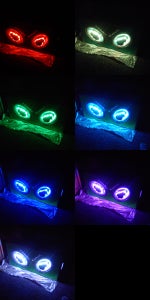

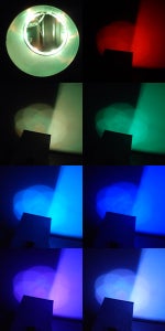

To make the Ghettoblaste glow, I used RGB-LED,s. I installed them on the speakers and in the bass tubes. I got a really cool light effect from the tubes which you can see in the last step's photos.
Step 4: The Electronics
I kept the controls simple. I decided to use one main switch (the red one) to turn the amplifier on and 3 white switches to control the 3 LED colors. Unfortunately I forgot to add a 12V regulator to adjust the voltage for the LED's, the fully charged battery brings it up to 14,5V:D. I also added two battery connectors and a charging port on the outside. The whole wiring was quite tricky but in the end I got everything soldered and insulated:).

I cutted a square piece out of a perforated metal plate as a cover for the battery hole. With some hot glue I fixed the bass tubes and the electronic components . After this I could finally attach the sides to the box with nails and some wood glue.
Step 6:
To make the blaster easy to take along I made a handle out of an old lashing strap and two small pieces of the metal sheet that I also used to cover the battery hole. To make it I cutted the strap to the right lengh, pleated the ends around the metal pieces and sewed it together.
Step 7: Painting It
I painted the rest of the assembled box in gray and silver.
Step 8: Connecting the Battery
A 12V lead-gel battery powers the device. With some velcro and rests of the lashing strap the battery is held in place but still easy to remove. Now the ghettoblaster was ready to use. With a selfmade charging cable I'm able to charge the battery through the charging port without taking it out.
Step 9: The Result
So this is how the finished project looks. I loved it but I wanted to sell it to have money for another project. It took two days until somebody bought it for 120 Euros. That was much faster than I expected it to be sold so I haven't had any time to have fun with this Ghettoblaster :/ //time will heal any wound and the money might also help to survive the pain ;D. However, I really hope you like it and if you do please vote for it :). Thank you for reading:).
