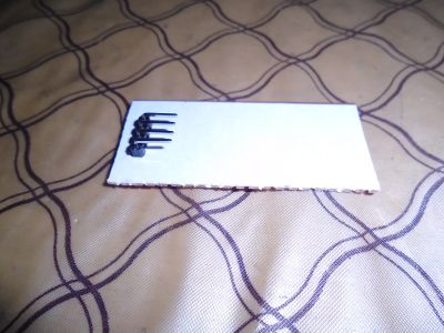

Step 6: Making Final PCB
- Start by soldering IC socket on to board, I used SMD package so i made a kind of breakout for it and soldered it on the perforated pcb.
- then solder the 4 wires from ribbon wires to IC for connecting relay board and its power supply( image 3 ) terminate it with female headers, it will connect to the male headers of relay board.
- then solder led using two wires.( image 3 )
- connect 2 meter long cable for pir sensors as they need to be mounted.
- set up the plastic enclosure for housing the entire circuit and make holes into in for wires to come out.
- then make some mounts for pir sensors( refer to image 8 and 9 ) using plastic cover from xbox game.
