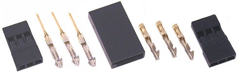

1 Pin Crimpers (AM1521-PC)
1 Servo Wire (SW22ST)
