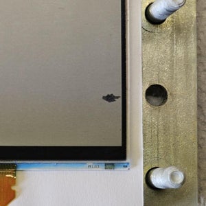

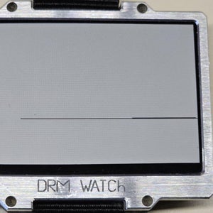

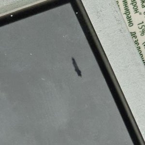

Step 1: How Leak Looks
There's a lot of possible LCD types of damage: Physical Cracks, Dead Pixels, Burn-In image, Leaks, Manufacturing defects.
My lethod is about recoveryng leaks. Here's some photos of damaged LCDs I successfully recovered with my method.
Obviously, this method will not works for other types of damage.

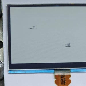

Step 9: Tests: Cold+Pressure
Initially display was damaged by shock front impact and line started appearing after few hours after impact and grows for about 2 weeks.
I placed display to pressure fixture and move to freezer.
After hour of freezing I disassembled to see how display changed. You can see on 3th photo.
Then I placed again to fixture and left freezing for 10+ hours.
Then when I disassembled again - display was fully recovered and still works like new.
