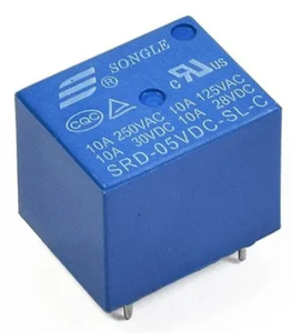

Within the wide variety of projects that we can do with ARDUINO, we may want to control high voltage or high amperage components, such as light bulbs or water pumps, which cannot be managed directly with ARDUINO. In these cases it is necessary to use Relays or Relays, these devices allow to control high voltage loads with a small signal.
The module has 1 high quality relay, manufactured by Songle, with capacity to handle loads up to 250V/10A. The relay module has a power indicator LED (red) and an activation indicator LED (green). This module, unlike the relay modules of 2 or more channels, does not have optocouplers, instead the relay activation is by means of a transistor. The module design makes it easy to work with ARDUINO, as well as with many other systems such as Raspberry Pi, ESP8266 (NodeMCU and Wemos), Teensy and Pic. This Relay module activates the normally open output (NO: Normally Open) when receiving a logic "0" (0 Volts) and deactivates the output with a logic "1" (5 Volts). For programming the use of Relays with ARDUINO it is recommended to use timers with the "millis()" function and thus not use the "delay" function that prevents the system to continue working while a relay is activated/deactivated.
Among the loads that can be handled are: light bulbs, light fixtures, AC motors (220V), DC motors, solenoids, solenoids, solenoid valves, water heaters and a variety of other actuators. It is recommended to make and verify the connections before feeding the circuit, it is also a good practice to protect the circuit inside a case.
