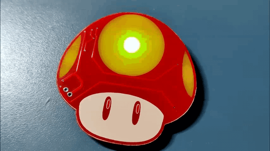

Hey what's up guys, this is the SHROOM PCB Badge that is themed after SHROOM from Super Mario.
This wearable Badge is made completely from PCB I got from PCBWAY and is powered by an Attiny85 which is in the SOIC8 Package.
I added three WS2812B LEDs to this badge which are visible from the front side of the board.
These LEDs are placed in an inverted position so their glow will be visible from the front side through the soldermask opening I left in both layers.

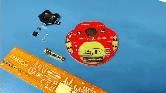

Following were the componenets I used in this build-
  • custom PCB
  • Attiny85
  • WS2812B LEDs
  • 1uf 0805 CAP
  • Brooch pin
  • SMD Coin Cell holder
  • CR2032 cell
  • Attiny programming setup (Arduino nano)
  • SOIC8 Clip

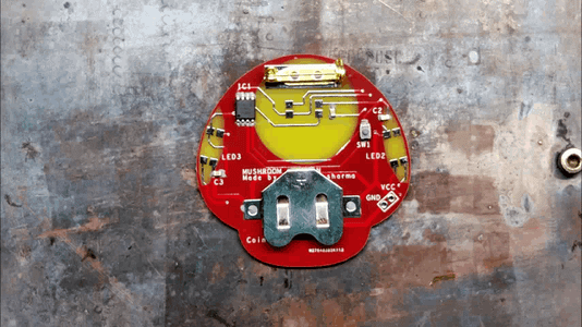

Step 5: PCB Board

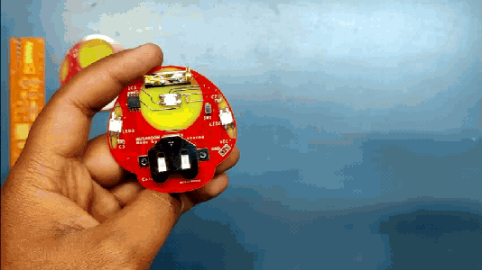

I first imported the Shroom image and use it as a PCB Outline and a few of its details were used to make a silkscreen layer.
All the components that I'm using are SMD ones so I placed them at the backside, I placed LEDs in the circle area.
Why? because I added a soldermask opening in the circle area and now the glow of leds would be visible from the TOP side.
Also, I'm using an inverted custom footprint that I made for these WS2812B LEDs.
We have to solder LEDs upside down instead of soldering them normally.

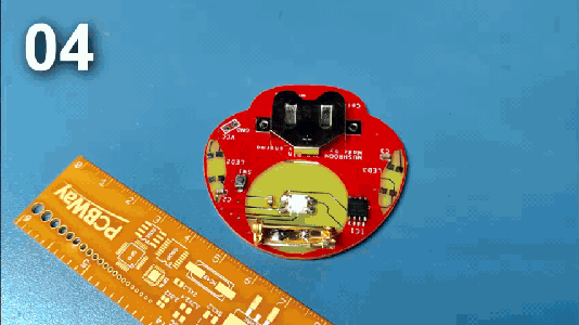

Step 7: PCB ASSEMBLY
These are the steps for the main assembly of the Shroom Board
  • Solder paste Dispensing Process
  • Pick & Place Process
  • Hotplate Reflow
  • LED Placement

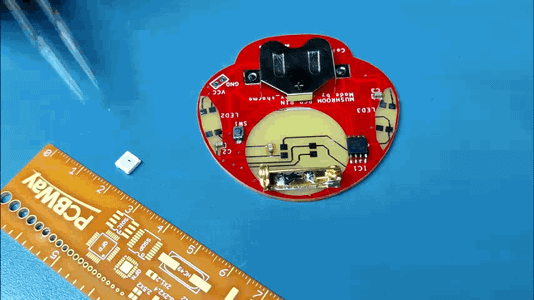

Because this PCB Doesn't have any Through-hole component, we do have to add LEDs with a soldering iron.
Step 8: SOLDER PASTE DISPENSING
Now the first step is to add solder paste to each components pad one by one.
To Apply solder paste, I'm using a Solderpaste Dispensing Needle with a Wide syringe, and the solder paste I'm using is a regular solder paste consisting of 63% Tin and37% Lead.
Step 9: Pick & Place Process
After applying Solderpaste we move on to the next step which is to add components to their assigned location.
I used an ESD Tweezer to place each component in its place.
Step 10: Hotplate Reflow
After the "Pick & Place Process", I carefully lifted the whole circuit board and place it on my DIY SMT Hotplate.
the hotplate heats the PCB from below up to the solder paste melting temp, as soon as the PCB reaches that temp, solder paste melts and all the components get soldered to their pads, we lift the PCB and then place it on a cooler surface for a little bit, to cool down the heat of PCB.

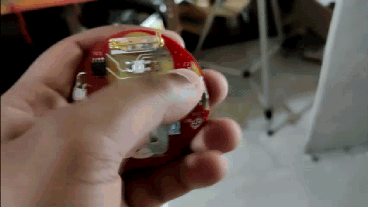

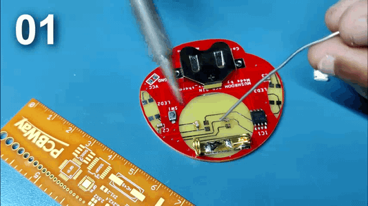

Step 11: LED Placement
As for the LED placement, I first added solder wire to one pad and then connected the LED pad with it.
The key here is to be quick as overheating the LED pad would affect LED's plastic casing and it may melt.
Then we add solder wire to the remaining pads and redo this process on two more leds.

Step 15: RESULT
here's the result.
