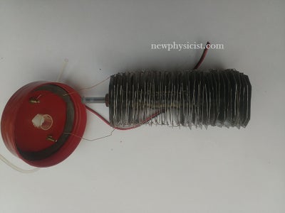

Step 1: How to Make

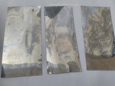

Take steel sheet

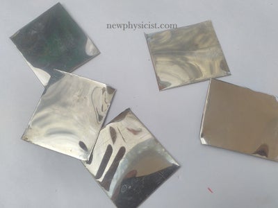

cut it into 2.5"*2.5" pieces

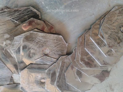

make holes at the centre

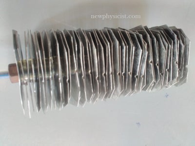

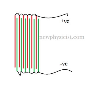

connect them as shown in the diagram

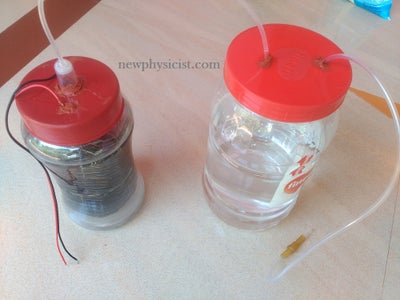

Place it inside a plastic bottle
Make a hole on the bottle and connect a plastic pipe.
Connect lead wires

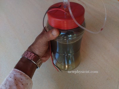

Use silicon to make the bottle air tight
Pour salt water into the bottle
close the bottle
connect leads to 12v battery
That's all
Test
