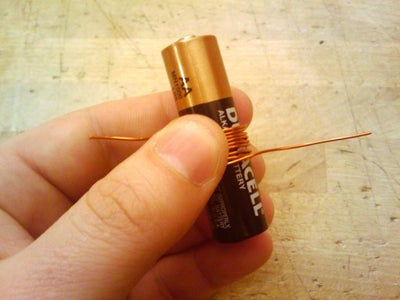

Wrap the wire around battery, leaving about 2" extra on each end.

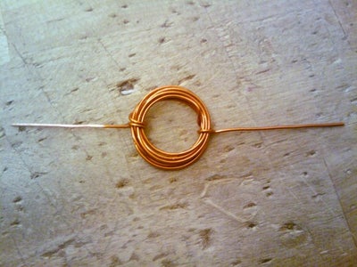

To keep the coil from unraveling, wrap each end around the coil a few
times. The two ends should be on opposite sides of the coil from each other.

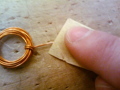

Step 3: Step #3:
Using the sandpaper, rub off all of the enamel insulation from one end of the wire.
Step 4: Step #4:
On the other end, strip off the insulation from one side of the wire,
radially. The purpose of this step is to allow the coil to turn on for part of its rotation, and then to turn off on the other part.

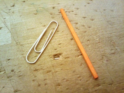

Gather the paperclip and a toothpick or other piece of scrap wood.
Stick the toothpick into the paperclip, next to the middle curve, and bend the paperclip to create a small loop. Repeat this step so that you have two motor stands.

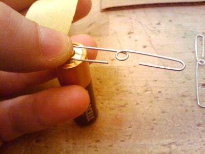

  • Next, take one of the paperclip stands, and tape the larger end to the
    positive battery terminal, making sure that the metal from the paperclip touches the metal battery connector.
  • Then, take the other stand and tape it to the negative battery terminal.
