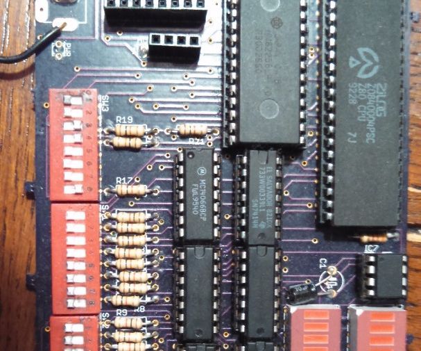

Step 2: Here's a Better Picture
For now, unless anyone here wants to know how I built this simple machine I will not put up a guide. If you want a guide feel free to ask! I will be happy too. Here is a better picture of the board I designed and soldered. This is the BAREBONES z80 (with a few extra chips). I love seeing other projects so feel free to comment with your own projects! I will continue to update as I solder my next version!

Step 4: BRAINSSS.....actually Just Brain
Well its been a while! I got stuck on one problem for a while, the Chip Select mechanism. In logic I had it down, but hand soldering leads to many errors. Anyway, after a good amount of time testing, I fixed it and ran some assembly code that sent data to the CPU, then sent data to ram, the read from ram, and sent it back to rom. It worked! That means my main "Brain" is complete, including all the major components of CPU, RAM, ROM. I still have to solder an on-board time circuit as of right now I am utilizing my arduino to time, and I will also add some debugging tools on my board assuming I have room after IO, Oh, also some pull down resistors on the data bus, but those are not super necessary at the moment. Anyway just wanted to show my progress!
