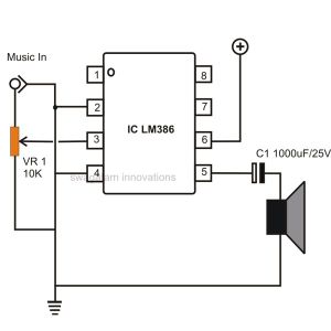

THIS IS A VERY SIMPLE AUDIO AMPLIFIER THAT USES JUST ONE MAIN IC 386 THT YOU CAN EASILY GET FROM RADIO SHACK OR ANY ORDINARY ELECTRONICS SHOP
Step 1: TAKE AN AUDIO INPUT PIN
ATTACH IT WITHIN THE CIRCUIT YOU MAKE
Step 2: ATTACH AN AUDIO OUTPUT JACK AND HANDS FREE OR HEADPHONES TO IT
ATTACH IT TO THE CIRCUIT
Step 3: ADD AN CAPACITOR TO IT
OF ANY VALUE BTW 1UF TO 10000 UF
Step 4: TROUBLESHOOTING
CHECK OUT ALL THE WIRES AND THE VARIABLE RESISTOR
Step 5: TO GET BASE INCREASE THE VALUE OF CAPICITOR
OR WITH DECREASE IN ITS VALUE U WILL GET SHRILL SOUND BUT WTH A HIGHER FREQUENCY
Step 6: TO INCREASE THE VOLUME ADJUST THE VARIABLE RESISTOR
