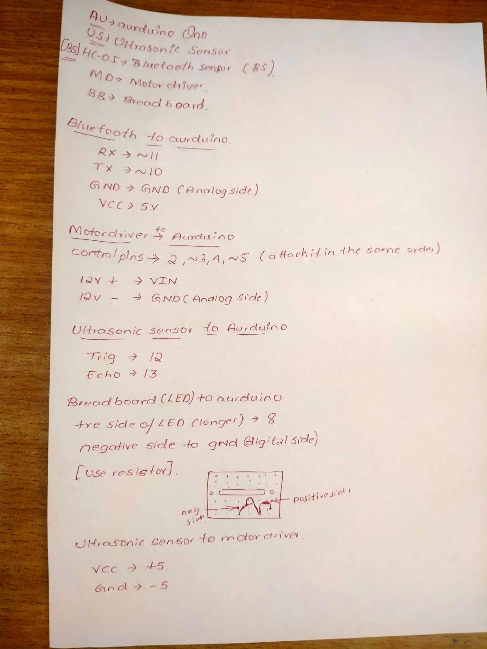

Step 4: Connect Motor Driver to Arduino
Then join the four control pin of motor drive to arduino 2nd,3rd,4th,5th socket using M-F wires
Step 5: Join Motor Driver to Ultrasonic Sensor
Join the motor driver to ultrasonic sensor from -5+ to ground and vcc of the sensor using F-F wires
Positive side of motor driver to vcc of ultrasonic sensor
Negative side of motor driver to ground of ultrasonic sensor
Step 6: Connect Motor Driver Power Supply to Arduino
Take M-M wires and connect motor driver power supply to arduino vinand ground
Positive side to vin of arduino
Negative side to ground of arduino
Step 7: Add Ultrasonic Sensor to Base and Connect Sensor to Arduino
Connect the echo and trig section of ultrasonic sensor to the 13th and 12th section of digital arduino socket.
Connect ultrasonic sensor to the base using Rubber bands.
Step 8: Connect the HC05 Module to the Arduino
The Bluetooth module has four primary points which are:
Vcc
Gnd
Tx
Rx
Now the gnd and vcc of the Bluetooth should connect to ground and 5v of the power side of the arduino respectively.
The connecionare done using M-F wires.
Next the Tx of Bluetooth Is connected to 10th port of arduino
Rx of Bluetooth connected to 11th port of arduino
Vcc
Gnd
Tx
Rx
Step 9: Attach the Led to Arduino
Using a bread board the led is attached to the arduino with the positive end to 8th port of arduino
And negative side to ground in the digital side of the arduino.
Make sure there is a resistor at the positive side of the led to prevent burn out.
The connection are made using M-M wires
NOTE:longer side of led is positive and shorter side is negative
