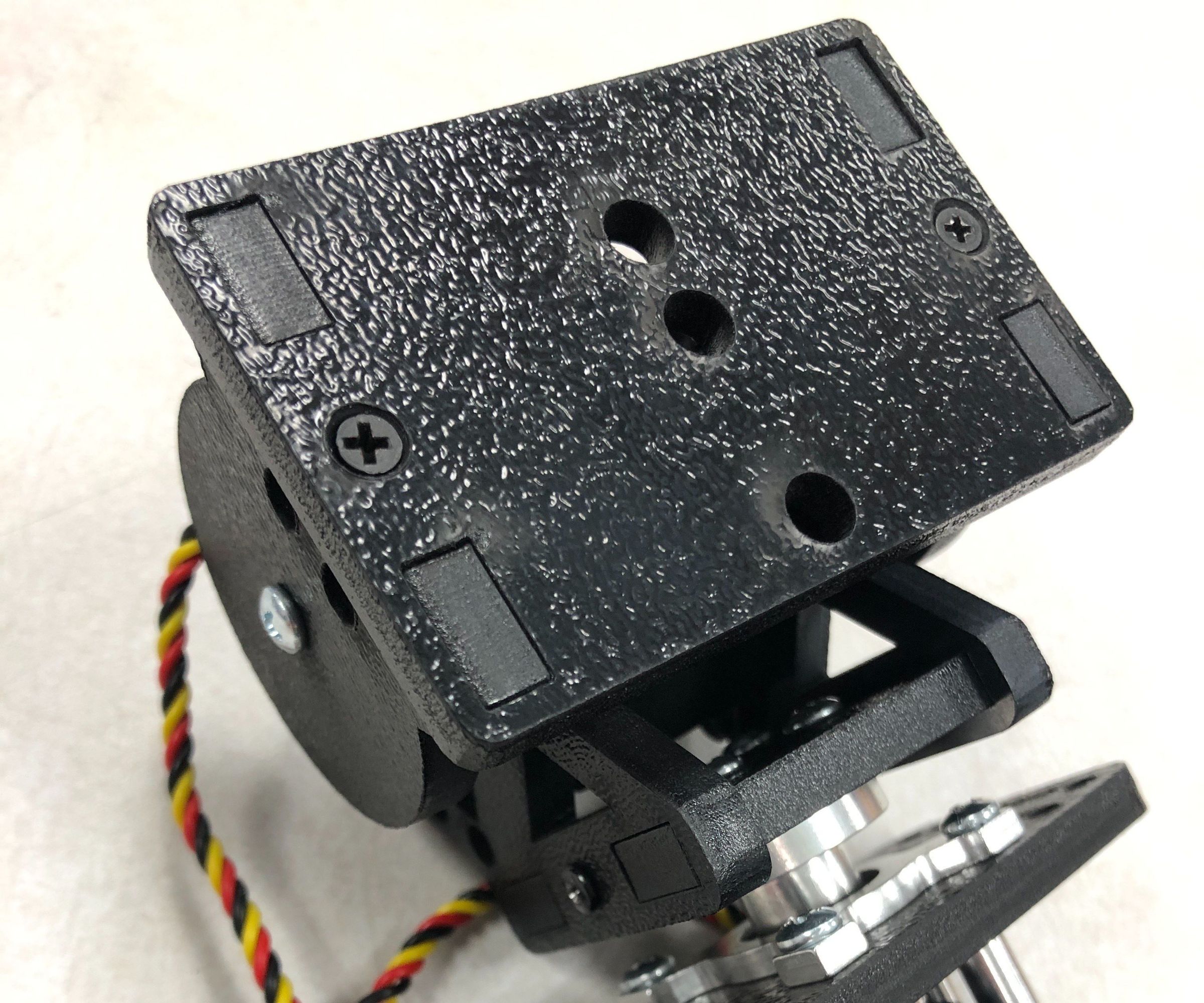

Step 6: Wrist Assembly (SPT 200 Pan and Tilt Kit)
The SPT 200 pan and tilt kit is used as the wrist. This pan and tilt kit has two degrees of rotation which is optimal for the hand to perform difficult letters such as "J" and "Z". These letter require wrist movement to perform the correct action. Please refer to SIRA Robotics build of the SPT 200 pan and tilt kit for assembly directions for this part. Once assembled, insert the kit inside the forearm on the top side as seen in the picture. The kit will be secured once the other cross-section of the forearm is attached.
Step 7: Attaching the Palm to the Wrist
Place bolts into the base plate of the SPT 200 Pan & Tilt kit. Place the Assembled palm on top of the plate and align the bolts into the holes of the base of the palm plates. Fasten the bolts with the nuts on both sides.

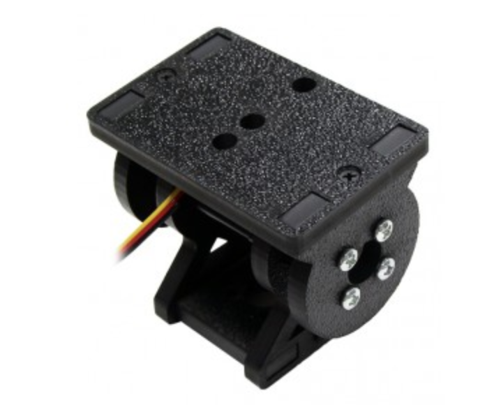

Step 11: The Elbow
For this step, you will need to have assembled the DDT 500 Tilt Kit. For directions on this assembly, refer to SIRA Robotics instructable build of the DDT 500 Tilt Kit. Place the assembled DDT 500 Tilt kit into the slots at the bottom of the forearm shown. Feed the wires of the Tilt kit into the back of the forearm and connect it to the pins shown. Place the opposite side of the forearm and it should snap into place in connection with the DDT 500 Tilt kit and the part of the forearm with the motor controller.
