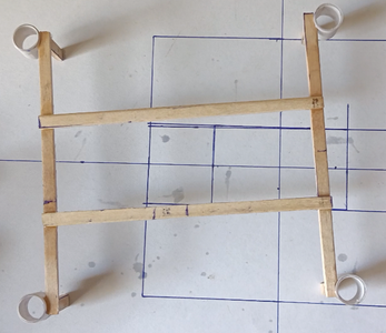

Step 1: Designing the Main Frame
Let's begin with main frame for our drone. I used popsicle sticks due to thy are light weight and hard enough for our drone and also easily available in stores.
At first I have sliced the popsicle sticks in half then drew the simple fame and glued them in as per the design.
I have also attached some landing sticks.

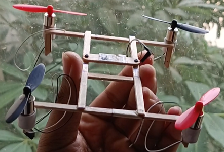

Step 3: Adding Motor Holders to Frame
Now it's time to add motor holders to the frame. As in the Image I glued them on the frame. Make sure they are straight facing top, if any one of them is not straight will cause our drone unstable.
Step 4: Inserting Motors to the Frame
Now insert 4 of the coreless motors to the holders attached with the frame and make sure to add propellers 2 clockwise and 2 counter clockwise as in the image.

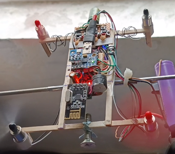

Step 5: Flight Controller With Receiver

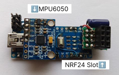

To make the flight controller I'm using ARDUINO NANO, MPU6050, NRF24.
I mounted the MPU6050 above the atmega chip and modified the ISP connector connection for the NRF24.
AMS1117 3.3v regulator is also attached to provide sufficient voltage to NRF24 and also 100uf capacitor to the NRF24 positive and negative to reduce some noise.
Step 6: Adding Motor Driver Board
This custom designed motor driver board with SI2302 N channel MOSFET can drive 4 brushed motor individually. Each output can deliver upto 2.5 Amp of current which is sufficient for our motors.. Normally 8520 coreless motor with 55mm propeller consumes 1.2-1.8 Amp of cuurrent. I have also added some connectors for the battery and motor which will hep us to plugin and plug out the battery and also the motors, we can simply swip the motor wires if it's rotating in the wrong direction.
Step 7: Adding Flight Controller and Voltage Booster
Now it's time to add the main controller FC and the 3.7 to 5v boost converter in our drone.
I glued the flight controller to the center of the frame(make sure that the MPU6050 should be on the center of the drone.
I'm using a single cell 3.7volt 25C li-po battery so to provide sufficent power to the main board I used this small size 5volt booster.
Step 8: Attach the Battery
I'm using a 650 Mah 25C 3.7(4.2max) volt li-po battery which is attached at the bottom. I will suggest not fix the battery with the frame, to manage the drone load distribution you can adjust the battery position and also to replace the battery easily.

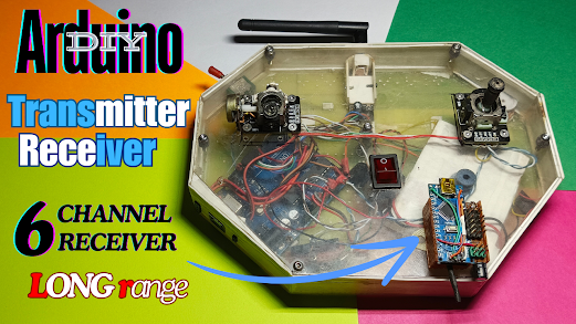

Step 11: Little Bit About the Transmitter
I,m using fully arduino based 6channel transmitter which I created some months ago.
The transmitter has a main controller ARDUINO UNO and a NRF24L01+PA+LNA antenna module and 2cell 7.4 volt rechargeable li-ion battery for longe operation time. Link of that video is attached. Video is available on my channel.
I have used AUX2 as ARM/DISARM and AUX1 for angle/baro/horizon.
