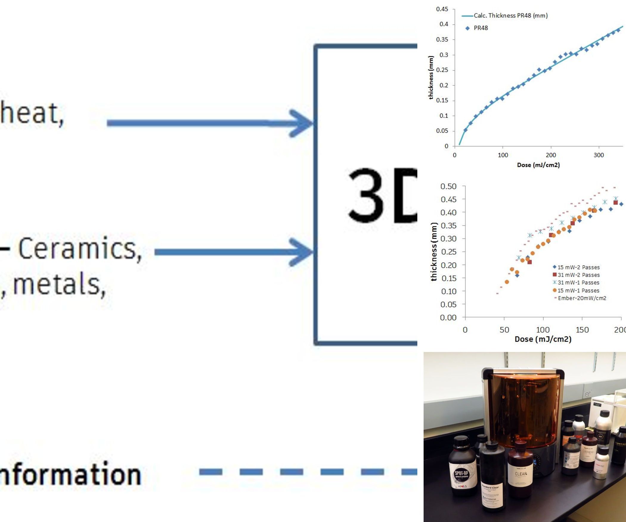

A 3D printer is basically a very specialized chemical reactor. It has inputs of light and energy, and it outputs waste and valuable products. The big difference between a 3D printer and a more typical reactor is that in most chemical reactors the information input is a combination of concentration, mass, momentum, and temperature gradients, which along with the reactor geometry, ultimately dictate the final product. Unlike most chemical reactors a 3D printer is capable of precisely controlling when and where energy is applied in the system, making it more controlled in some sense.
The implication of this approach is that 3D printers can readily be understood with simple chemical engineering models. This Instructable explains the most pertinent of these models to printer settings development. Ultimately, these models are much simpler than reality, and the rules devised from these should be treated as heuristics, i.e. they will get you 80% of the way there, but will give erroneous results sometimes. This is not a thesis, this is just a collection of simple rules of thumb for starting to understand DLP/SLA printers.

The most important model for understanding a 3D printer is the "working curve" (or work function) that describes the thickness of the polymer that forms as a result of light absorption, as seen in the above figure. This model come from the combination of two other simple models. First, as light passes thru an absorbing media its intensity decays in an exponential fashion described by the Beer-Lambert law. Second, when a photopolymer resin absorbs enough light (i.e. energy) it undergoes a very rapid transition from a free flowing liquid to a solid (albeit a very fragile gel).
The consequence of these two models is that as a photopolymer is illuminated nothing happens until the critical energy is reached and polymer first forms at the the window surface. Subsequently, the layer then slowly glows in thickness away from the light source.
Mathematically this result is obtained by re-writing the Beer-Lambert law in terms of energy (rather than light intensity), and then solving for the thickness:
layer thickness = dp * ln ( Dose / Ecrit),
where the penetration depth (dp) describes the penetration of light into the resin (dp = 1 / sum(extinction coefficient * concentration) for all of the resin components), and critical energy (Ecrit) describes how much energy the resin takes to cure. Both of these constants are very important, as measuring and understanding them is key to getting any resin to work, and we'll get back to later in a later instructable,
