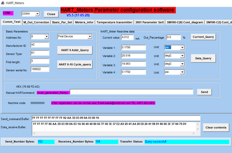

Step 4: Verifying Communication With the Instrument
  1. Go back to the included software screen
  2. Go to COMM_Test tab
  3. Change the drop down to the correct COM Port and push the button with silly letters
  4. Hit HART 0 ADDR_Query → you should see some text in the bottom section called “Send_command Buffer” and “Data_receive Buffer”
  5. Hit the HART 0-15 Cycle_query button. I dont know what this info is.
  6. Hit the Current_Query button. You should get the current mA value.
  7. Hit the Data_Query button – you should get the current engineering units value (temperature and pressure in this case.
  8. You can press on the pressure device and click Query to obtain the new values. Each time you press query you will get the current "snapshot"
