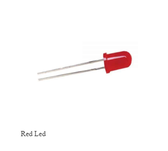

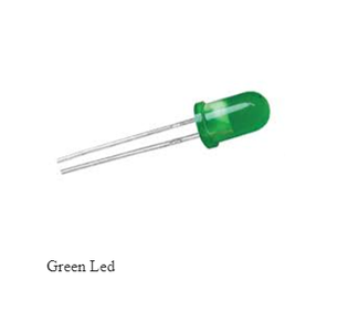

1) LED Red and Green
  • It's a semiconductor device that emits light when an electric current is passed through it.

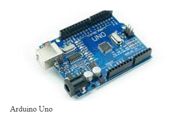

6) Arduino Uno
  • To read input like light on a sensor, a finger on a button, or a Twitter message and to turn it into an output like activating a motor, turning on an LED, or publishing something online.

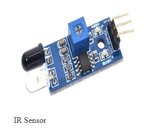

10) IR Sensor
  • To emit light in order to sense some object in the surroundings.

Secondly, in the same circuit, we added the IR Sensor to measure and detect infrared radiation in its surrounding environment from:-
  • OUT pin to pin 2 of Arduino Uno
  • GND pin of IR to GND of Arduino.
  • Vcc pin of lR with Vin of Arduino.

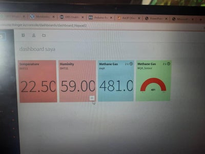

Step 5: Test the Project
After we successfully set up the NodeMCU and Thinger.io platform as in step 4, we can see the readings of temperature, Methane Gas, and humidity from the sensors as picture above once the coding is uploaded.

Step 7: Finale Output
We placed a grapefruit into a medium-sized food container to test the fruit's condition. The levels of methane gas, humidity and temperature of the grapefruit at the appropriate time points were recorded. As the output, we can conclude that the methane gas of the grapefruit is higher than 250F which is 357.0F, and it is considered spoiled and not in good condition. The red led also blink when we test the grapefruit's condition. Not only that, but because of the DHT 11 sensor, we also could monitor the temperature and humidity of the grapefruit as well.
