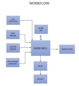

In this rapidly growing world, using technology to create a smart home that ensures both safety and power efficiency is becoming a primary demand. Home Automation and Security system is an IoT based project wherein the electric appliances and devices like air conditioners, lights, door locks and gates can be controlled and monitored remotely. The Internet of things (IOT) refers to embedding things with sensors, software and other technologies over internet for data exchange. This project focuses on developing a smart home that embodies smart door system; controlling the appliances in a room from the smart phone; face detection using camera; and smoke and LPG detection. It sends notifications about detection of smoke and gas leakage. The security is ensured by surveilling the entry points like doors in case of any suspicion or breach, the owner is notified with the image captured by the sensor at the instant. The proposed system is designed using Wi-Fi as an Internet connection protocol. Android app is used to control the home appliances.

The android application used for controlling the smart home devices is BLYNK.
HAAR algorithm is used for face detection.

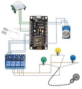

Step 2: Hardware Assembly
Step 3: Programming the Node MCU
Connect the node MCU to laptop/computer and upload the code.

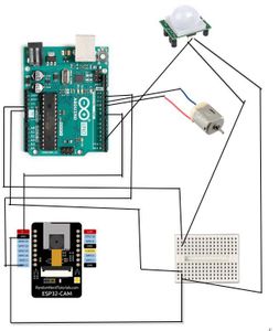

Step 6: Working on ARDUINO
This program is to be uploaded in the Arduino. If motion is detected by the pir sensor, the camera turns on. If the camera finds a match, the motor trigger pin turns on and the motor rotates. The motor here is for the door lock system.

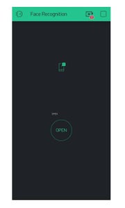

Step 7: Setting Up Blynk App
Create a Blynk Account and create a New Project. Choose the hardware. An authentication token will be sent to your email id for every new project created. Create the project and add the widgets as shown
