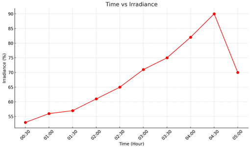

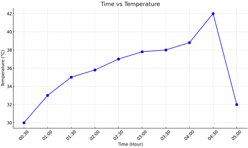

  1. The Arduino Uno R4 continuously monitors the DHT22 sensor for temperature and the LDR for light intensity. If the temperature, irradiance, and humidity exceed the set threshold by a caregiver, the Arduino sends a signal to the relay to cut off the power to the socket, effectively shutting down the phototherapy machine.

  2. Widgets to monitor temperature (°C), humidity (%), and light intensity (LDR values) in real time.

  2. If the temperature, humidity, or light irradiance exceeds the caregiver-defined thresholds, an email notification is sent immediately via Gmail integration.
  3. This ensures that caregivers are informed promptly of abnormal conditions that may require intervention.

1. Temperature Behavior
The experiment commenced at 00:30 with an initial temperature of 30°C. As the phototherapy progressed, the temperature increased steadily, reaching 35°C by 01:30, 37°C by 02:30, and 38°C by 03:30. By 04:30, the temperature peaked at 42°C, surpassing the 40°C safety threshold, which triggered the system's automatic shutdown to prevent overheating. Following the shutdown, the temperature gradually decreased, reaching 32°C by 05:00, allowing the device to resume normal operation.

3. Irradiance Progression
Irradiance began at 53% at 00:30 and steadily increased throughout the phototherapy session, reaching 65% by 02:30 and 75% by 03:30, approaching the 85% safety threshold. By 04:30, it peaked at 90%, surpassing the threshold and contributing to the system's shutdown. After the reset at 05:00, irradiance dropped back to 70%, ensuring safe conditions for the infant.
4. System Shutdown and Recovery
The critical moment occurred at 04:30 when both the temperature (42°C) and irradiance (90%) surpassed their respective thresholds, prompting the device’s automatic shutdown to prevent overheating and excessive light exposure. Following a brief reset, the system restarted at 05:00, with all parameters returning to safe levels: temperature at 32°C, humidity at 63%, and irradiance at 70%. This demonstrated the device's effective real-time response, ensuring a safe environment for the infant.
Time vs Temperature Graph
The graph illustrates the temperature progression over time, beginning at 30°C at 00:30 with a steady rise through the early hours. By 04:30, the temperature reaches its peak at 42°C, the highest point on the graph. Following this peak, there is a sharp decline, with the temperature dropping to 32°C by 05:00. This sudden decrease likely corresponds to an external factor or a system reset, as suggested by the system shutdown mentioned in the data. The peak indicates that the temperature exceeded a critical threshold, triggering the system's intervention.

Time vs Irradiance Graph
The irradiance plot demonstrates a consistent rise over time, beginning at 53% at 00:30 and steadily increasing until it peaks at 90% by 04:30. This peak aligns with the highest temperature and the system shutdown, indicating that both temperature and irradiance reached critical levels. Following the system reset, irradiance dropped back down to 70% by 05:00. The steady increase in irradiance before the shutdown suggests that the system was exposed to escalating light or energy until it exceeded its threshold.
General Observation
  All three graphs temperature, humidity, and irradiance demonstrate similar patterns of gradual change throughout the experiment, culminating in significant shifts at 04:30, when the system likely exceeded its predefined safety thresholds. At this point, the temperature peaked at 42°C and irradiance reached 90%, resulting in an automatic shutdown of the system to protect the infant from unsafe treatment conditions. The sharp changes in these variables after the shutdown underscore the system's ability to respond to out-of-range values and restore balance.
After the system reset, the recorded values for temperature, humidity, and irradiance began stabilizing by 05:00, demonstrating the system's effectiveness in restoring safe phototherapy conditions. These trends highlight the importance of real-time monitoring and automatic interventions in maintaining optimal treatment conditions and protecting vulnerable newborns from potential harm during phototherapy.
