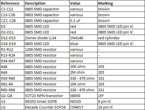

To successfuly build an electronics project, you will generally need a schematic and a bill of materials (BOM). The schematic shows you how the circuit works, and the BOM shows you what parts are used. The kits from Bangood came with no documentation, and the website has only a partial schematic with the wrong reference numbers.
The best information I've found comes from an Ebay listing which provides the schematic and a board layout with component references and values on it: https://www.ebay.com/itm/2Sets-DIY-SMD-SMT-Compone... While it has a BOM, there is no reference numbers on it, so it is not much help to us. The hand-drawn images are both quaint and informative.
The best BOM I've found was from a forum post https://forum.banggood.com/forum-topic-240555.html), and even it is a bit scattered, so here is my synthesis:
Realize that for the practice areas, the values don't mater, only the package size. If you decide to do the practice areas first, be sure to set aside the components needed for the working circuit, namely:
- R48, R49, C27, C28, and R61-64.
