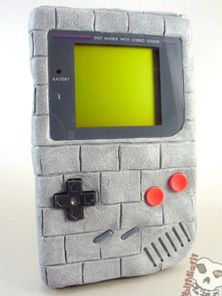

I usually clean and paint these while I have them open for an even more personal look.
HOPE THIS WAS HELPFUL!!! ENJOY!
You can see the rest of my mods and customs at www.thretris.com
