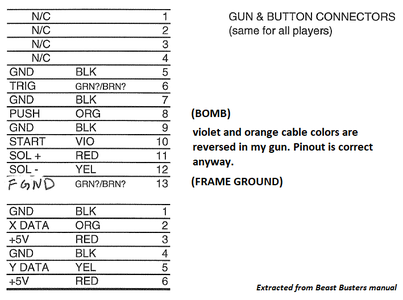

This gun has three switches: start button, trigger and "bomb/grenade" button). These can be tested easily with a digital multimeter in diode test mode.
Coils are actually a more or less long wire spiral. Their main cause of failure is going open circuit. You can test them by measuring the resistance between the two pins. A reading around 20 - 30 Ohms (or lower) for these small coils is typical.
The coils SNK used work best @20V, but could also be powered @12V if a weaker recoil is ok for you (or your kids).
A special mention here deserves the so called freewheel diode (or flyback diode). The freewheel diode is used to protect the driver circuit from getting damaged by the excessive reverse voltage created by the coil any time it is de-energized. Being the diode placed in parallel with the coil, you cannot test it in-circuit. You have to desolder at least one leg and then test it the usual way. It's a general pourpouse 1N4005 diode on these SNK guns, but a 1N4004 would also work (it did in Midway's Terminator 2: Judgment day on a similar coil).
Potentiometers are variable resistors. To test them you can put your digital multimeter in resistance measure mode with one lead to one of the external pins and the other to the middle pin (the so called "wiper"). SNK positional gun assembly mounts two, 5K Ohm linear (B) potentiometers, one for each picture axis/direction. Badly working potentiometers can often be fixed by using some electronics cleaner spray, especially if they were left unused for a long time.

Everything sorted out, it was time to bench test everything (I already had a clear idea of cricuits and softwares I was in the need for), then design a dedicated PCB (see dedicated Step for details).
