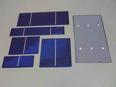

Solar Panels are basically a cluster of photovoltaic cells that convert the sun’s energy into electricity.
These photovoltaic cells each convert the sun's energy into electric energy, but each cell can outputs from 0.4V to 1V depending on the type and we can get desirable current by reducing its size.
As for its working principle, Photovoltaic cells are sandwiched between layers of semiconducting materials such as silicon. Each layer has different electronic properties that energize when hit by photons from sunlight, creating an electric field.
This is known as the photoelectric effect and it’s this that creates the current needed to produce electricity.
To get 5V, these cells are connected in series and then in parallel for getting a decent current rating.

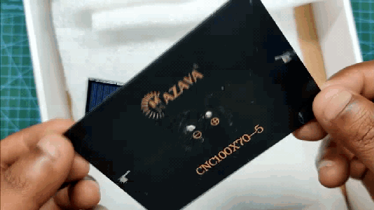

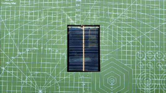

Step 2: Getting the Right Solar Panel
As for the Solar Panel that I'm using in this build, I got this panel from PCBWAY's Giftshop that you guys can check out.
Their Giftshop contains all the major components that include dev boards, different kinds of sensors, and even stuff like the solar panel module that I'm using.
The Module that I'm using has 10 solar cells connected in series so I'm guessing each can output 0.5V, then this line is in parallel with another 10 cells so that would mean each line is of 5V 100mA so two lines would make 5V 200mA.

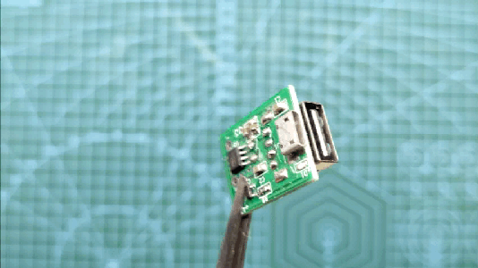

What I'm gonna use is a powerful Boost module circuit which is based around IP5306 which is a Power Management IC generally used in Powerbanks and mobile devices.
IP5306 is a fully-integrated multi-function power management that comes in the SoC package.
It has an internal Boost Converter setup along with a proper Li-ion Battery charge management setup that has a low discharge and high charge cut feature which is a must-have function when working with Li-ion cells.
Li-ion cells are dangerous if overcharged so we generally use a BMS Module to cut off its voltage when attached to any charging source, IP5306 has this function which means we dont have to attach any Battery protection setup with it.
Also, we get battery status LED Indication feature.
It can boost the Voltage of any cell from 2.8V ~ 3.7V to 5V 2A.
checkout its datasheet from here- http://www.injoinic.com/wwwroot/uploads/files/2020...
I found this IC's USB Module online and implemented it into my project.

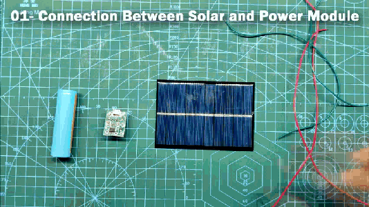

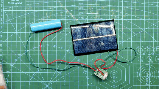

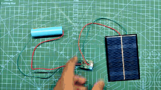

Step 4: Wiring of the Whole Setup
By following the above wiring diagram, I made the connection between the IP5306 Module battery and the Solar panel.
I connected the Solar panel's positive and negative to the Micro USB Port's positive and negative as solar panel in an input power source that will feed voltage into the system for charging application.
Then I added a Li-ion cell with its assigned pads.

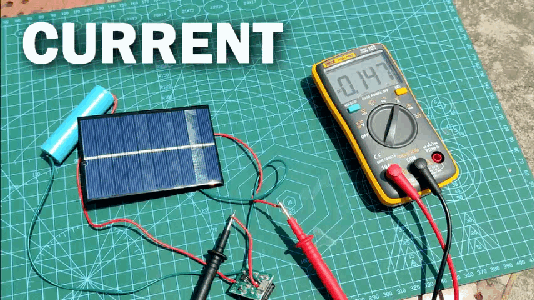

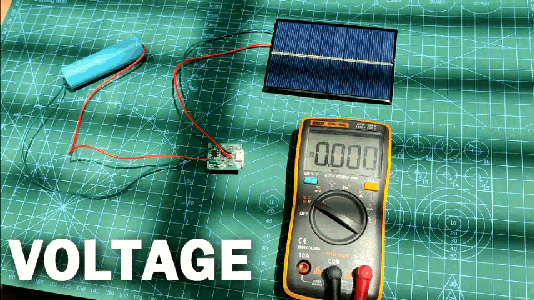

After doing the basic wiring, I took this Setup outside for testing the voltage and current status of the whole system.

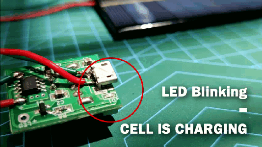

Step 5: Testing
For testing this setup, we need to put it under bright sunlight and first check its voltage which should be between 4.5V to 5V.
LED of IP5306 LED should start blinking which shows that the battery is now charging.
Li-ion cells usually require 4.2V in order to get fully charged, if we are getting 4.5V or 5V it's okay because the IP5306 has an internal HIGH Cut feature that cuts the input power of the system as the voltage reaches the 4.2V threshold.
Then after measuring the voltage, we measure the current which should be between 200mA to 100mA depending on the battery voltage, Lithium cells tend to draw more current when their voltage lies between 2.2 to 3.1V, after crossing that limit, the current gradually decreases.
btw here are some calculations that I did.
The power of the whole solar module is around 0.6Wh (4.5V x 0.147A)
But the cell requires 8.14Wh power to get fully charged, the time required for charging 8.14Wh from a 0.6Wh Source would be 13.5H (8.14/0.6).
Now 13 Hours is a lot of hours, also we need constant sunlight for charging this setup in 13 hours which is not possible at all.
For charging this setup, we need a more powerful panel or we can reduce the capacity of the battery from 2200mAh to 1200mAh.

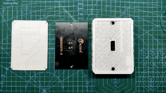

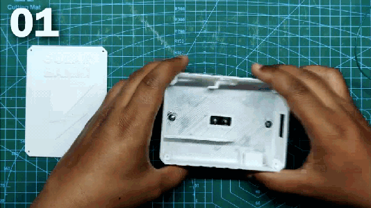

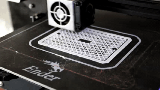

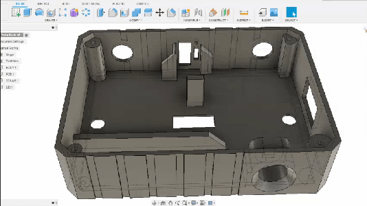

Step 6: 3D Printed Body

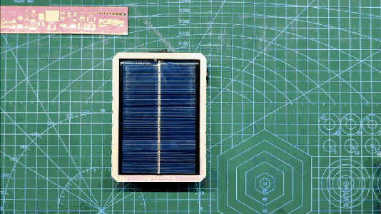

I prepared a rectangular body that houses the solar panel on one side and contains all the major electronics inside.
I used fusion360 to model the whole strictly and then 3D printed the body and its lid with my ender 3 by using the following print setting.
  • Nozzle Dia- 0.8mm
  • Infill- 20%
  • Layer height- 0.3mm
  • Support - YES
Also, if you dont own a 3D printer, you can check out PCBWAY's 3D Printing service.

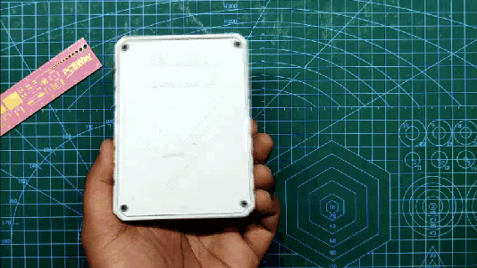

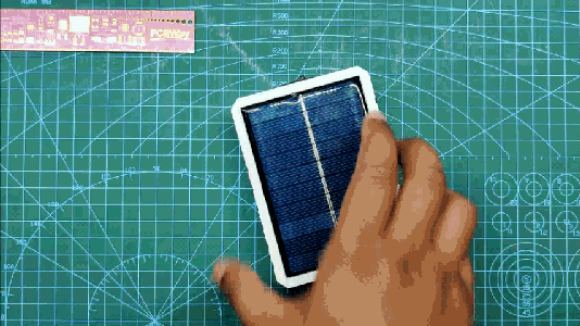

Before starting the Final assembly, I took the 3D Printed body and glued the panel on the outside, I used regular hot glue for this step and let the glue dry for a few mins.

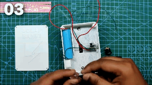

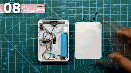

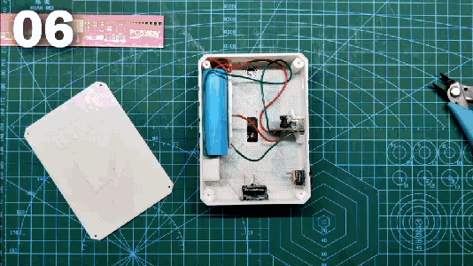

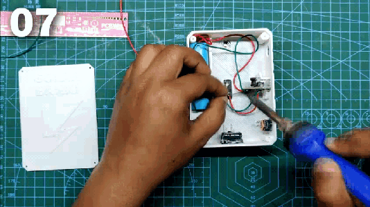

Step 7: Final Assembly

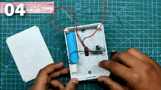

the main assembly which includes the following steps.

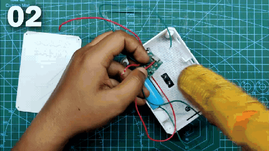

  • We first add a Lithium Cell to the main Body by using Hot glue to secure it completely in its place.
  • We do the same with the boost module.

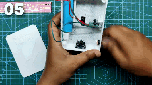

  • Then we add a 10mm LED in its place by using Hot glue.
  • After that, we add Rocker Switch in its assigned place.
  • Then we add a DC Barrel jack which will be connected in parallel to the solar panel output. (goal for adding this barrel jack is, we can connect an external panel with this setup as well for charging the cell)
  • Then we do all the connections which are shown in the Above wiring diagram
  • In the end, we tightened its lid with four M2 screws, and the assembly is completed.

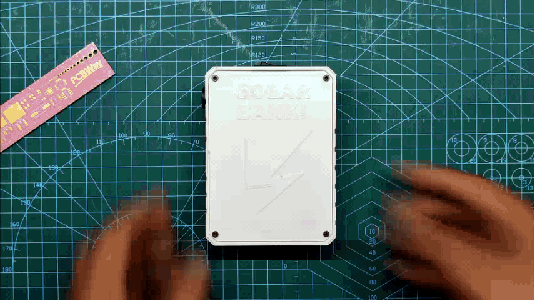

Step 8: Result and Conclusion

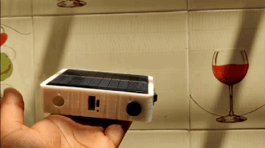

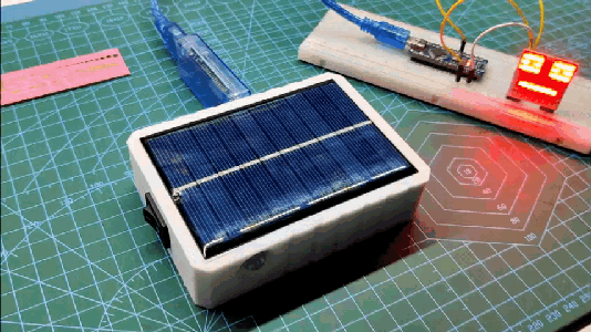

This was the overall result, a working handheld solar-powered 5V power source that is capable of running major Arduino projects.
We just plug any USB in it and power the device, it can even charge a smartphone, up to 2200mAh ( less than that because some power will be lost as nothing is 100% efficient)
During Nighttime or when the sun is not available, we can use its onboard micro USB Port to charge the setup.
